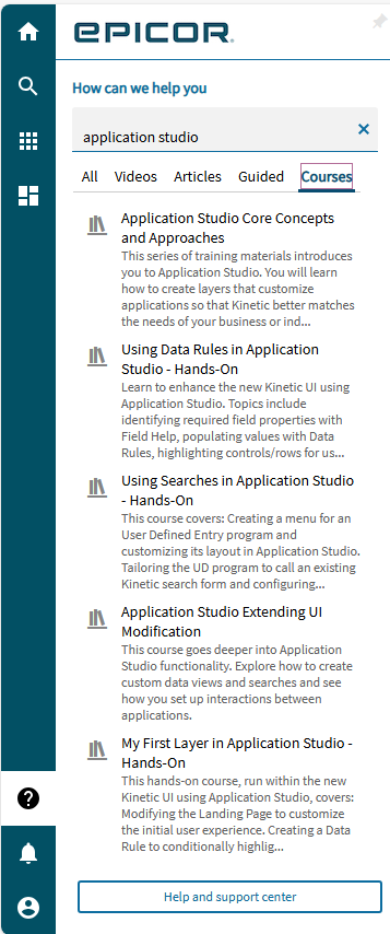

Oh, I forgot to mention that the Application Studio classes on the Epicor Learning Center are pretty good.
