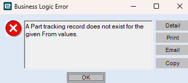

I have tried this. I receive an error when attempting. I’m not sure what it means.
We have fully indented bill of materials. Using a move material request on a subassembly that contains between 3 and 10 materials would be cumbersome. We’d like to be able to process the full assembly (that isn’t started yet) with the “Move WIP” option but it doesn’t seem to work correctly.
