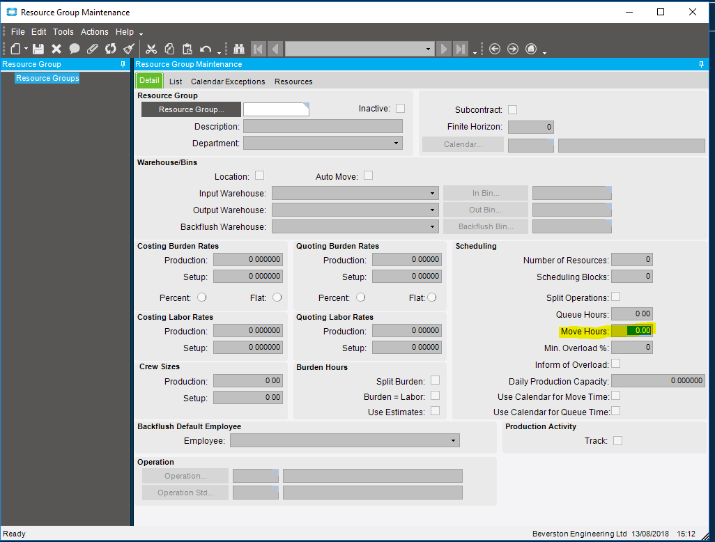

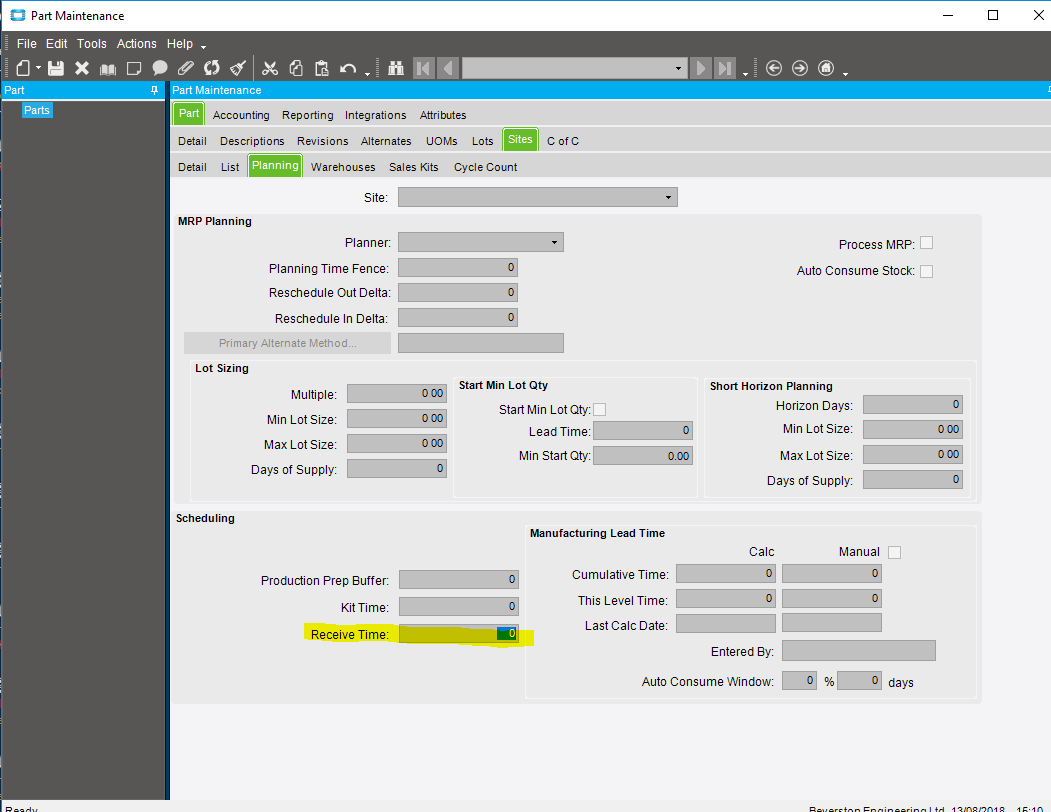

you may need to check the following:
  1. Receive time at part level.
  2. Move Hours at Resource/Resource Group.
Hi Al
Thanks for coming back to me. I’ve tried these and all are set at zero.

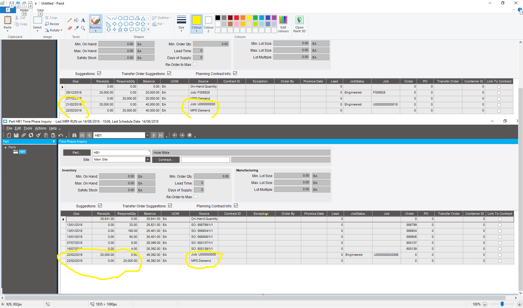

then i suggest to take one part as a case study in Live then in Pilot and run a filtered MRP, tick multi level pegging process, then check the Time Phase and the Multi level Pegging screen and compare its supply-demand for both databases
Hi Al
Please see below. The top result is where we are getting the difference.
in your Pilot database, could modify the demand to call the same amount on the same date, also replicate the same supply i.e create the similar jobs using same routing and required on the same dates, then run filtered MRP, and check the Time Phase again…
the next level of the investigation is check the different line which is in your case the demand on 21/02/19, open the Suggested job and check the scheduling between the operations as well as due date and compare.
Might also be worth checking the calendar on the last operations resource/resource group to make sure that there are no exceptions and also that the working hours are correct.
Failing that you can check the job in the job scheduling board. On the detail tab this will show the start and stop time of each operation - again I would focus on the last one.
