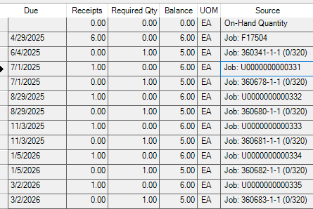

MRP creating un-required unfirmed job
We are getting extra unfirmed jobs for a specific part. It’s a subassembly setup to backflush which we have a firmed job (make to stock) for enough quantity, (6 pieces). But each time MRP run it creates additional unfirmed jobs for each job that they go on, which is setup over a long blanket. Why doesn’t it just use the firmed job quantity we already have scheduled? Time phase below

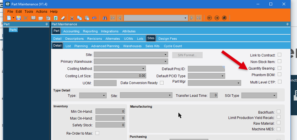

Are the child parts marked as non stock on the site tab or have a lot size in the planning tab ?
child parts are stocked & quantity bearing and have no lot size.
I’m assuming you did, but check the sites tab too. It’s possible that the sites and the general tab don’t match up.
Yes, double checked both. That was a learning in the past so i made sure to check it as well!

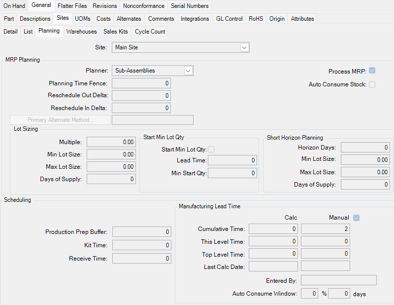

can you show a screen shot of the planning tab
Pretty basic stuff on this one.
Do you have a suggestion to reduce the firm job out there? You’re days of supply of 0 mean that it’s going to want to have the materials available on the specific day it’s required.
edit: yeah, that’s what you said. Yeah that’s what’s happening. The suggestions say that you don’t need the parts, so reduce the job that’s out there, and use the other ones instead. You’ll have to play with days of supply, time fences and some other settings to not see nuisance suggestions/unfirm jobs like that.
I think that’s it. You want to check both Locked (qty) and Locked (schedule).
If it still gives suggestions after running MRP again, then you might need to increase the Reschedule Out Delta on Part Entry for the subassembly (Sites > Planning).
