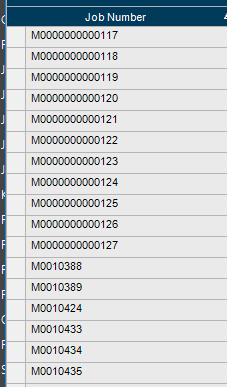

when a Job is created by the MRP process, the job is created with a 14-length characters (my prefix + balance of the total length)
I am trying to reduce that number.
I know there is a length field in Company Configuration, but the Length is only used when you use the Next Job numbering, not the MRP process.

This is a real problem for my client. If it’s an Epicor issue they will know but some time it’s faster here to get an answer, but since before it has a shorter length and whitout any “writing” something it change, I am wondering where the modificatrion can be done.

Basically, I am just wondering how to change the length of the job number. As mentioned, before they had a shorter job number, now it’s the full 14 character.(see image on first post).

Your screenshot doesn’t show the full Job Number - unless it’s a custom dashboard and M0000000000012 is repeated lots of times?

the first 3 digits are the prefix M00

The differences between the long and short number are, in Marsh it was a short number, now they are long (full 14 characters). my client doesn’t know what change, the only thing was maybe an Epicor Update.
