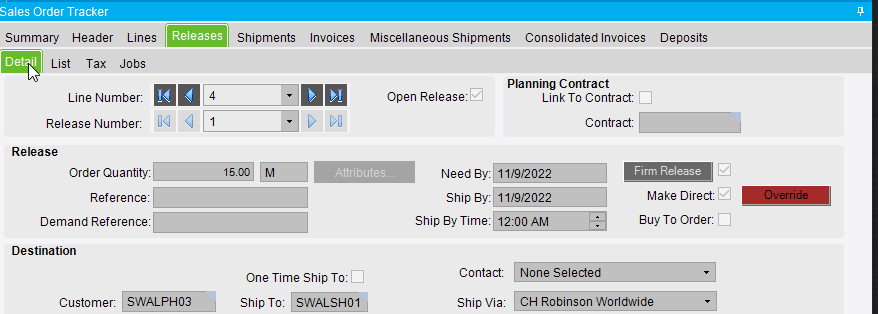

Override set properly via the customization

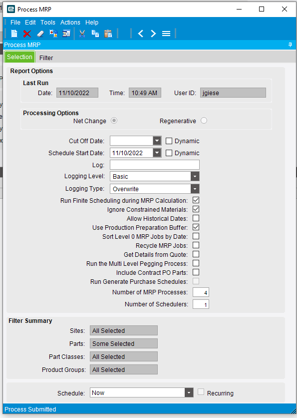

Ran MRP no cut off manually for this part

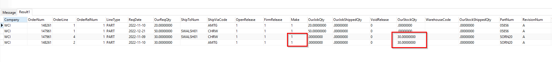

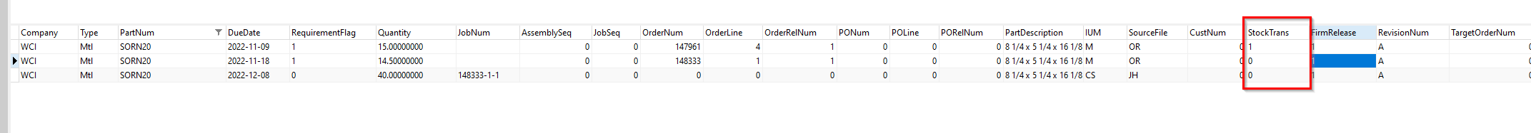

In your second example from the testing database, it looks like that order release is still pulling from stock instead of directly from the MRP job. It looks like the PartDtl record for this order release isn’t being updated when your directive changes it to Make Direct.
So it’s putting the qty in the StockQty field. That’s interesting.

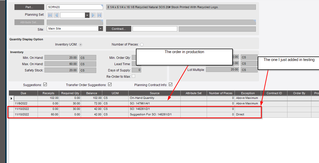

This is my testing DB. The line for order 148261 is showing a suggestion without any intervention

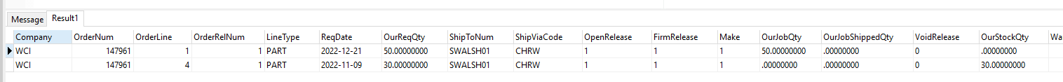

But that condition is the same in production where I just set that all manually

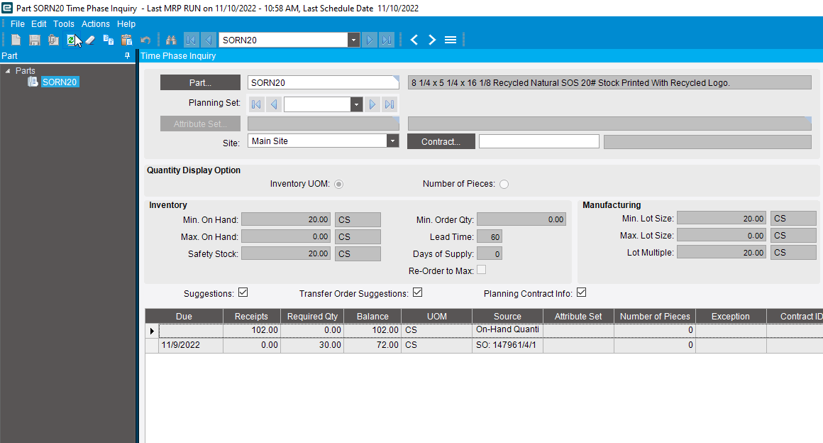

Oh I lied it created the “Suggestion for” then deleted it after MRP finished in production. So even manually setting this as make direct it’s not having it.
PartDtl has it marked as a StockTrans though which doesn’t make sense if it’s set to Make. These two lines are for the same order. One is a nonstock in Part Maint the highlighted is not marked as such.
That is the issue. It’s creating the PartDtl record as stock trans even though I want make direct. I forced it to 0 and ran MRP it made my job.
Going to see if I force the Qty into job qty on the release if that makes PartDtl behave.
I think that worked. I updated my BPM to move the qty from OurStockQty to OurJobQty and when I released the order the PartDtl got created with StockTrans = 0
