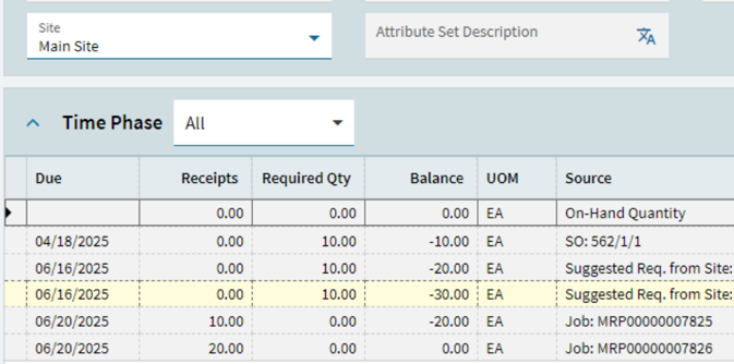

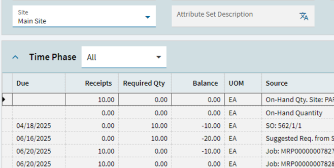

Thank you. I can now see two jobs — one for a quantity of 10 at the Main site, and another for a quantity of 20 at the RAK site. However, after I performed an inventory adjustment of 10 units at the RAK site and ran MRP, the existing job for 20 units at the RAK site was not reduced to 10. Instead, a new job for 10 units was created.
Before adjustment
After adjustment

It did get reduced to 10. look at your before and after. you have a suggestion for 10 not 20.
Before the adjustment, the job numbers were MRP00000007825 and MRP00000007826. After the adjustment, new job numbers MRP00000007827 and MRP00000007828 were created.
I’m not sure why the existing jobs were not updated instead.
Running a net change on a specific part is the same as running a Regen. it will delete the suggestions unless you select to reuse jobs in the MRP run. if those jobs were firm, you would have seen reduce or cancel suggestions.
