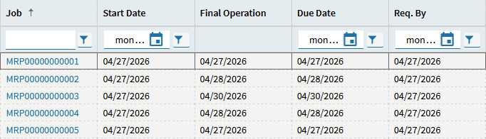

we want to implement MRP Scheduling in our Company, so we set up a Test Server were we can experiment and play around with the MRP scheduling process to see how it works.
In this test enviroment there are no materials or products on stock and no other firm or released jobs. Safety/Min Qty is also set to zero. We have 5 Ressources. We then created a single forecast entry for one finished part.

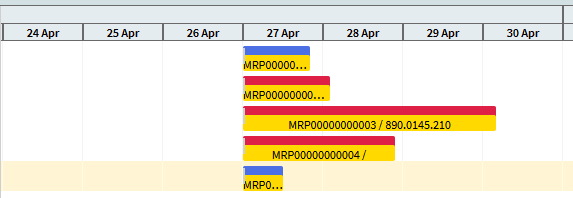

As we would expect MRP created 5 Jobs, one for every ressource. The Quantities for the jobs also makes sense to me based on parameters we have defined on the parts. But we dont understand the scheduling. We would have expect the jobs to be sequential, because Job A produces the material for Job B and so on. MRP-02 has a due date of 28th, but the job from the next assembly level MRP-03 is supposed to start on 27th. But in our logic MRP-03 needs to wait for the material to be produced from MRP-02 before it can start.

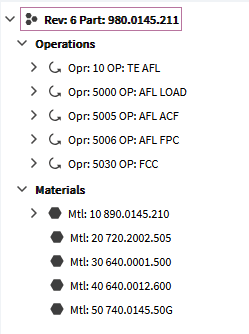

Hi, thanks for your reply.
we actually have multiple operations but we have always defined the first operation as final operation in the method, we only need the other operations for our MES interface.(We dont use Epicor MES)
Each job is for a individual part number and a individiual ressource. We have not defined subassemblies in the method. The parts are only linked through the material in the BOM.
MRP-05 is Level 0 and has the produced material from MRP-04 in the BOM, MRP-04 has the produced material from MRP-03 in the BOM, and so on.
lvl 0
lvl 1
The other levels look similar, some have more/less Operations and material.
I can see MRP understands that, because when i create a demand for the level 0 part ( through forecast entry ) it creates jobs through all the assembly levels, to level 5 in our case.
But if there is no stock, why are the jobs all starting on the same day ? Our expectation was that MRP understands that it first needs to complete the job for the lvl 1 part, before the job for the level 0 part can start, because it needs the produced material from the job for the level 1 part.

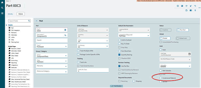

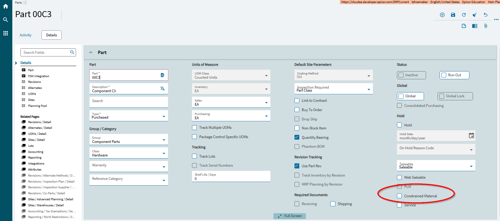

Have you turned on the Material Contraint flag? I believe that this might resolve the problem (if memory serves me correctly). Without this flag turned on, the system plans for material infinately, but with it on, it considers the material or assembly as a constraint when scheduling.
WARNING… it is not considered a good idea to turn this on for everything, as it will but a burden on the scheduling system. Typically, it would be turned on for those items that are harder to get and become a manufacturing constraint.

Regular (NOT constrained) parts are assumed to be expeditable, so MRP (or Generate Suggestions) produces a Change PO Suggestion saying that you need to expedite that PO. For Constrained materials, it doesn’t do that, but rather reschedules the job (if you’re using the Epicor Scheduling functionality) to match it’s arrival date.
So in practice, you’d want to mark critical materials that CANNOT be expedited as Constrained. The rest you coax (cajole, seduce) your suppliers to expedite.
