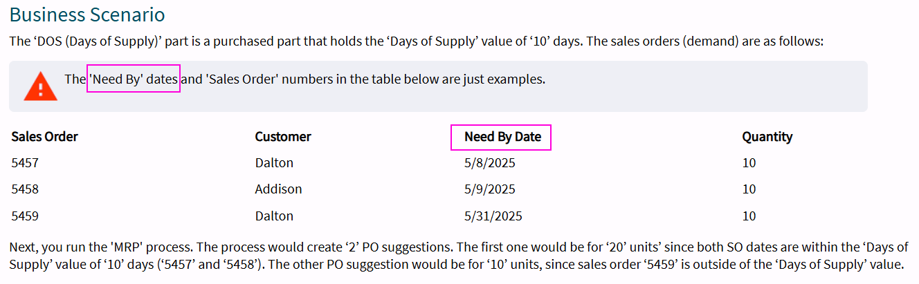

Days of supply simply groups all the requirements into buckets of the days of supply (DOS)…
example, if you have DOS set to 30, and you have one requirement per week of 10, 20, 20, 30… it will see the first requirement of 10 pieces, and then look ahead 30 days to see how many more you need… it would add up those and buy all 4 demands at once (10+20+20+30 = 80)… then it will look for the next demand… if the next one is out at 50 days later, then it starts looking from the 50 day mark and looks out 30 more days, and gathers up all the demands and sums them again.
The idea is that when you need to by 1, look ahead X DOS days to find how many more you need.

@timshuwy, I was just reviewing the DOS course on Epicor Learning Center, and I think they have made an error. The course specifically states that DOS calculations in MRP work off of Need By Date for demand from an SO release. But I believe they are based on Ship By Date for an SO release. (Job material demand is not mentioned in the course)
