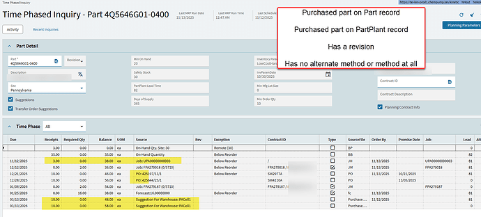

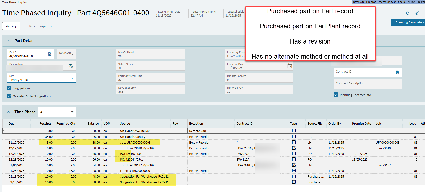

We are now getting erroneous unfirm jobs for purchased parts. Here is an example in timephase. Is anyone else seeing this behavior?
I have noticed that if I delete the revision on the part (we like to have revs for P parts too, no method just a revision, always have had this) or unapprove the revision on the part it then does not make the erroneous unfirm job.
This is a problem, we like to have revisions on our purchased parts, obviously in case a revision is made to the p part.

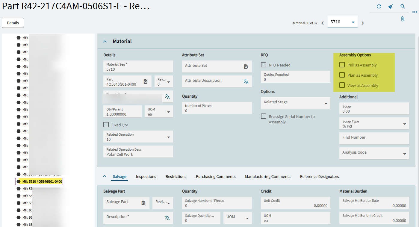

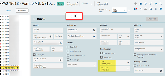

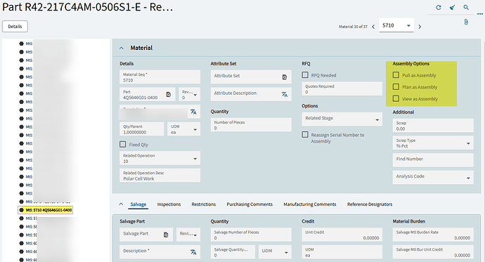

How are the parts on the emthods? Are they marked as Pull As or Plan As?
Hi John,

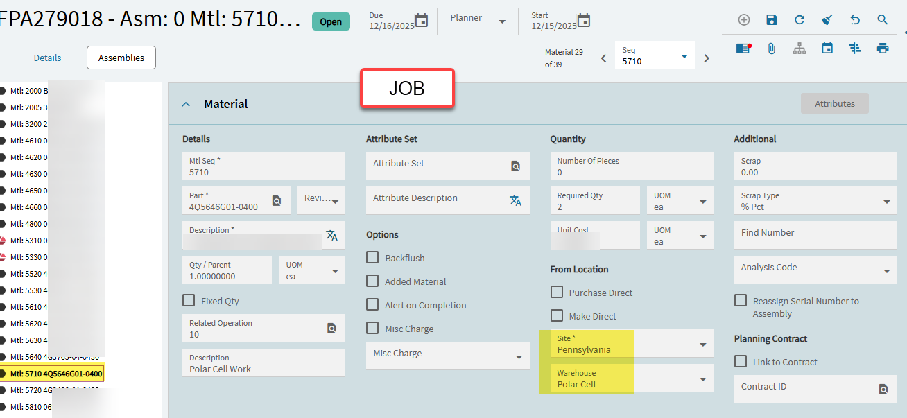

Nope. See below method. And on the demand job it is pulling from inventory.

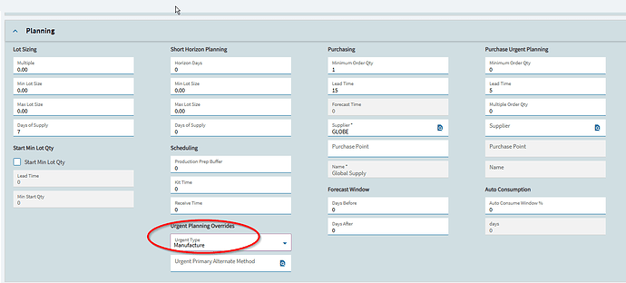

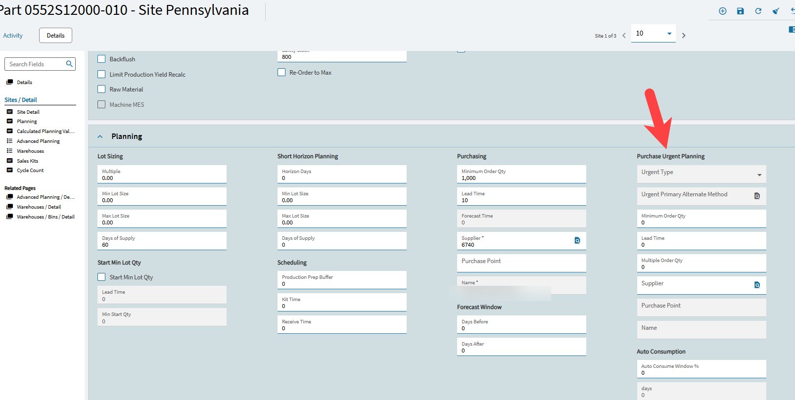

we have the new urgent planning feature that can turn a make part into a purchase part (and vise versa).. Check how that is setup on your system.
ALSO… check the make buy code in both the front page on the part, as well as at the site level. because you can have the default value in the Part record set to purchased, but the site level can say Manufactured

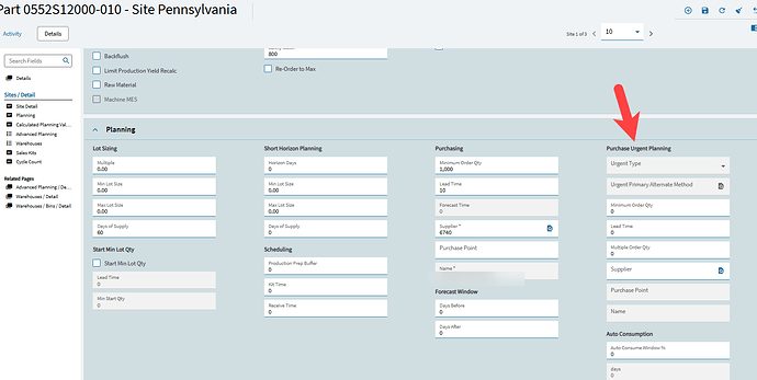

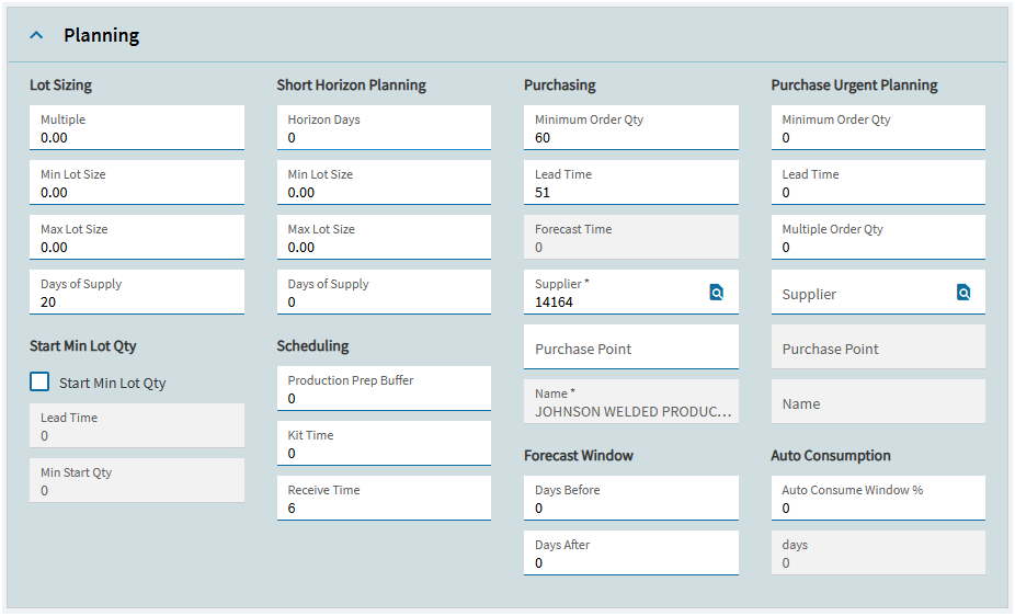

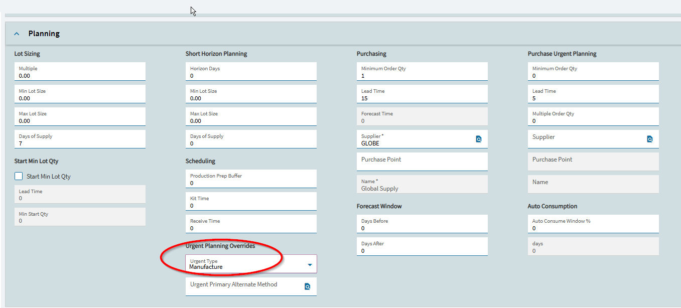

Thanks for this and the thoughts on the front page Purchased vs Part Plant Purchased Tim. They are all set for Purchase and then that Urgent Planning override.. I don’t think my version has that, it looks like this in base. I’m befuddled.

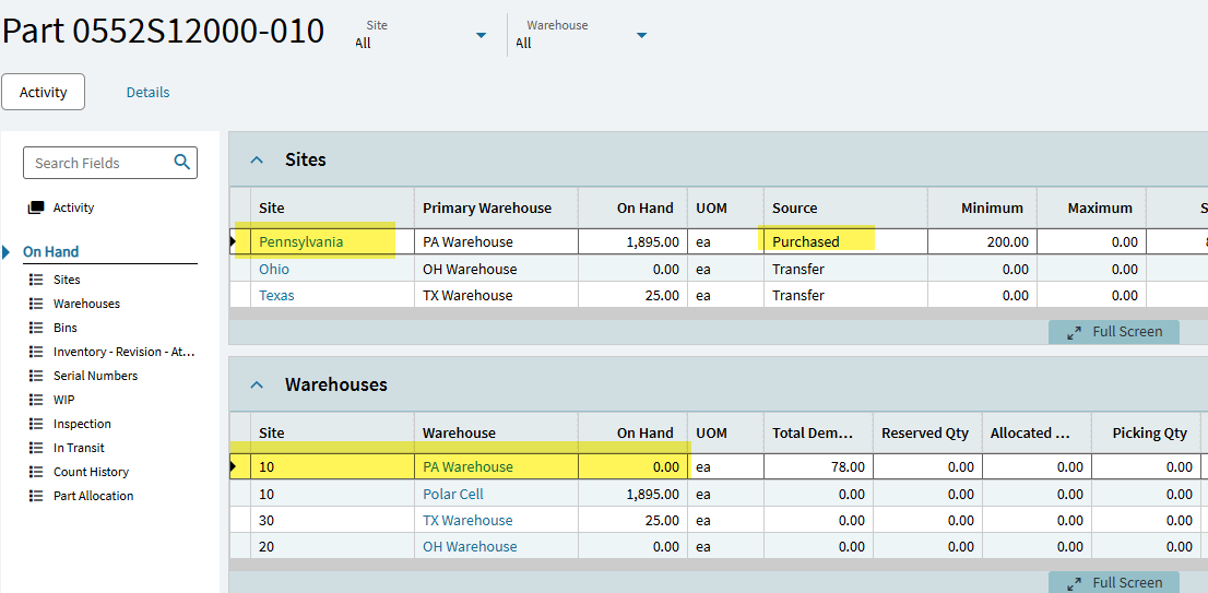

I have noticed that it is not happening to all of my P parts thankfully. It seems to be only my P parts that have zero in the warehouse where the Job is located but QOH in another warehouse in the plant.

I don’t (in 2024.2) but you do seem to have that. Tim’s screenshot looks different - he has those fields in a separate group-box - but you do have the fields. You have 8 fields on the rightmost column and I have 6.
Now, why are yours grayed out? (AMM?) And they are blank in your screenshot, so if that’s one of the naughty part numbers, then it still does not explain it.
