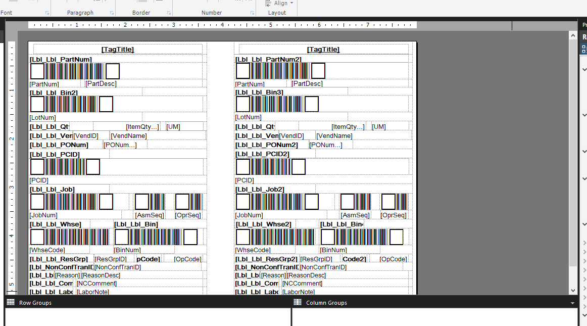

The standard report comes out 2 per page:
Here is the standard in report builder:

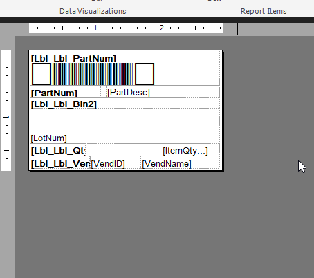

I copied that report style and stripped enough away just to test at 4x3 size and it will only print one label.
https://i.imgur.com/DWT98R5.png
Why it’s designed to print in pairs like this is beyond me, as is how to force it to print one label per page.

Thanks for the idea and continued help, Calvin, much appreciated! That’s basically what I did to get my current version that still only prints half of the labels as it’s still trying to print the other half to that second, now missing, label.

I could be wrong, but I believe that the original layout:
Only appears to be two labels. In SSR, that is one label that is 8" wide by 6" (?? the bottom is cutoff) tall. It just happens to print two of everything, side by side.
If your print just was just 1 record, you would have the same info on both the left and right sides. If you’re printing on to an 8-1/2"x11" page, this would give you the “two” side by side labels (really just one printout that spanned across two individual 4x6 labels). If your printer is only 4"wide, then the renderer will be forced to put the stuff that runs off the right edge (which would be all the fields on the right side), onto the next page.
BUT, this depends on the way the renderer is setup. Especially for PDF output. If the render is set for “Shrink to Fit”, it will shirnk the whole image to fit on one sheet. If that sheet is a 4" wide label, it would print at roughly 50%, and you’d see “both” labels (the left set of fields and the right set of fields) on one 4" wide label. If the renderer is set to maintain size, the right side fields would be forced to a new page - but no guarantee their placement would be positioned correctly on the label next label.

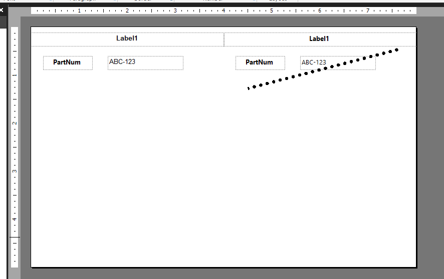

Maybe an exampl in Report builder would be clearer …

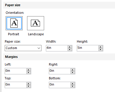

In all of the following examples, my target label is 4"x2" 4"x5"
Example 1: Two copies, side by side
  • report properties - > page setup: Custom, 4" wide, 5" high, all margins zero
  • Report Body Properties → size: 8", 5" (note that it is twice the width of the page size)
  • Report layout as shown. the same fields are on the right and left. The dotted line is just to show which set of fields are being used on the printout/preview. EDIT: All the fields on the right have the same Y position as those on the left, but their X position is exactly 4" more that its twin on the left.

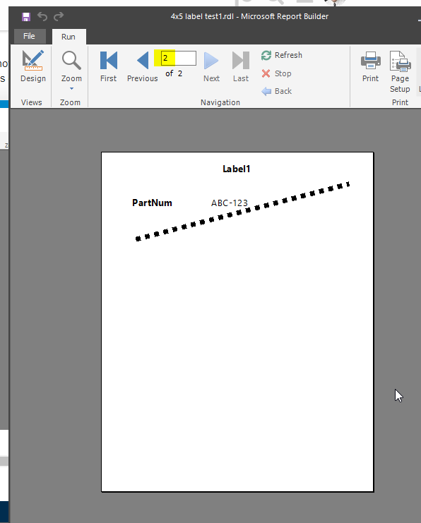

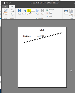

When I run this with Print Layou selected in Report Builder I see two separate pages:

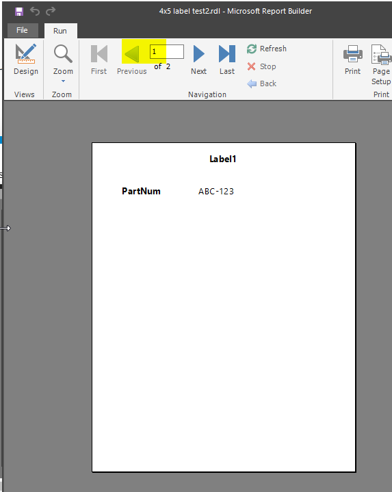

Example 2:
  • Same Page Setup 4 x 5, no margins, portrait
  • Report Body Properties → size: 4", 10" (note that it is twice the height of the page size)
  • Report Layout as shown. EDIT: All the fields on the bottom have the same X position as those on the top, but their Y position is exactly 5" more that its twin on the top.

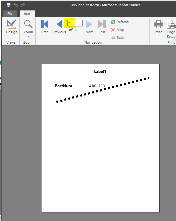

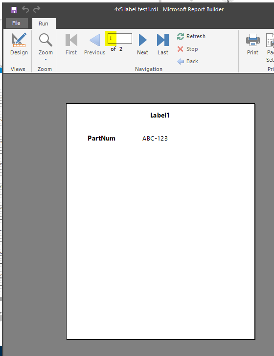

When I run this I see:
and
Edit
This report (using either method) will always give you two labels per record. So you’ll always have an even number.
