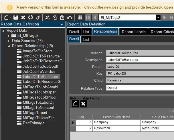

Hi,
Has anyone had similar situation? We have had custom MtlTags data definition which caused some agent fails due to bad relationships in data definition: LaborDtlToResource and LaborDtlToResourceGrp. We deleted these relations, but annoying thing is that these relations gets back after every major system upgrade and I need to delete them again. Any ideas why they apear again?
Mr. Justas: Yes i have the same thing with an RDD for a Bartender Label. I have removed 3 relations in the RDD and after EVERY upgrade the Relations are added back in. No Clue why.
I put a ticket in a while back - however, I never got an answer or resolution.
I just have it in my upgrade process now docuemented to always TEST in Pilot and update the RDD - Then Export the “Fixed” RDD and just import it on the Go-Live Weekend.
