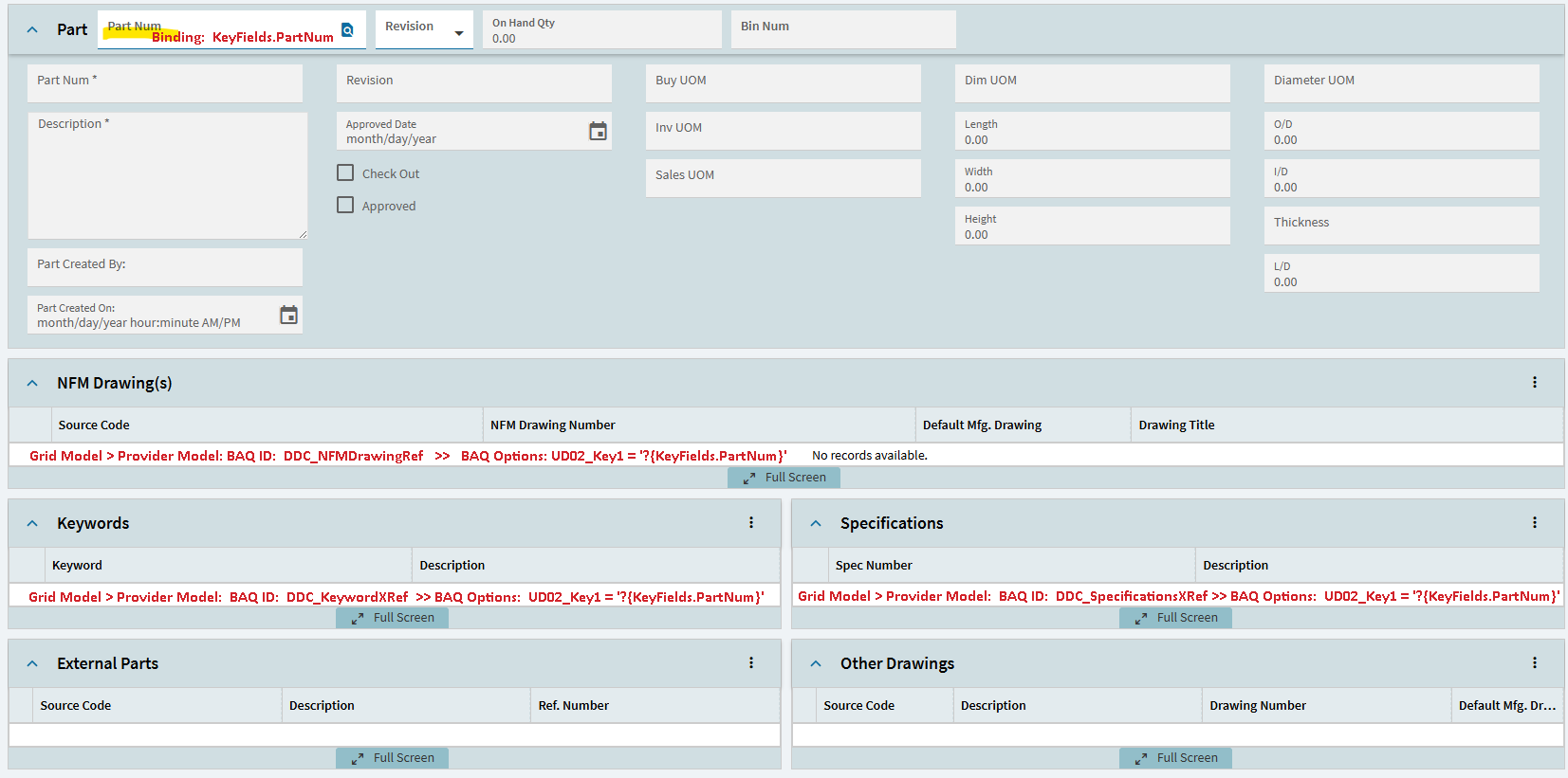

This is a dashboard I have that shows part information. The Textbox up top is bound to KeyFields.PartNum.
The (5) grids below are all driven by separate BAQ’s (NOT by dataviews). The BAQ ID is added to the Grid Model > Provider Model.
Then, in Provider Model, in the BAQ Options… I add a Where clause:
UD02_Key1 = '?{KeyFields.PartNum}'
Every time KeyFields.PartNum value changes, the BAQ’s automatically refresh and repopulate the grids.
If you have a grid that is populated by a DataView, I think you’ll need a DataTable > Column Changed event so when the value of your filter changes, you would re-run your kinetic-bAQ or rest-kinetic events to repopulate those dataviews based on the new filter.
Anyway, I know the above is not the same as what you’re looking for (I’m doing Part based stuff… not sales based stuff), but may point you in the right direction.
