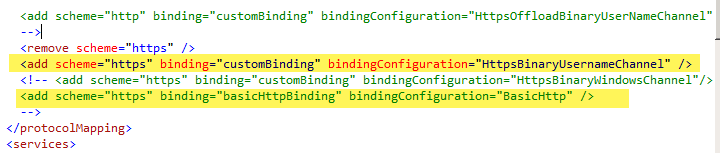

Can I have both of these active?
We use the HttpsBinaryUsernameChannel to allow certain users to bypass SSO.
I want to activate the basicHttpBinding for use with our integration tool with SalesForce.
no, only one binding per scheme is possible.
Bummer. Thanks Olga.
