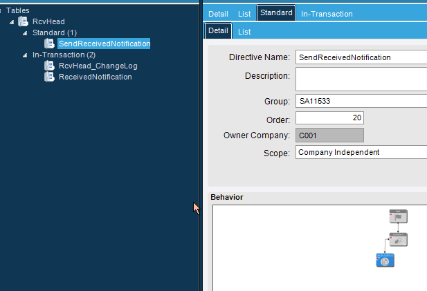

We have emails being send out via data directive on RcvHead so that when something gets received the buyer and/or part manager (UD Field in our company) can get emails notifying them if they have that selected (another UD field(s) to control that). That all works fine except for one weird quirk that I can’t figure out.

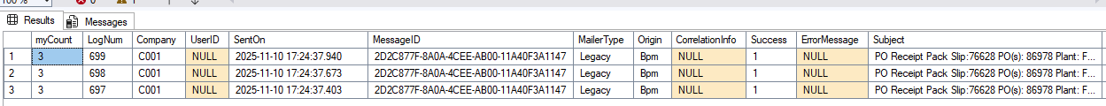

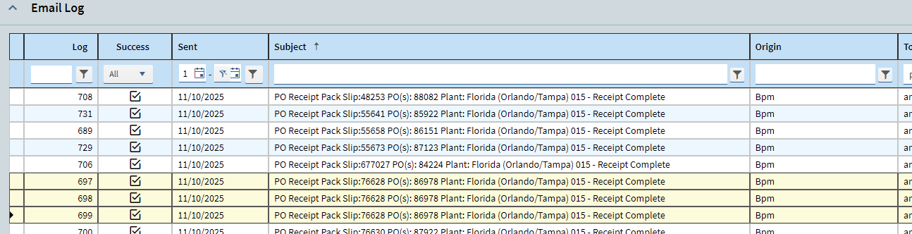

Sometimes, (not always) it’s sending duplicate emails. I can see in the email headers that the duplicates are coming from different app servers. We have 3 and when it duplicates they usually get 3. One from each server. I can tell that from the email header. Also, these aren’t the only emails that we are sending that are duplicating, it just seems to be that these are the most often duplicated emails, or at least the ones the users have told us about. I do see some other ones in the logs.
In the log on the back end where you can see times, you can see that they are sent at almost the same time, so don’t think it’s a verification issue like I saw in this post. (although I could be wrong). They also have the same message ID.

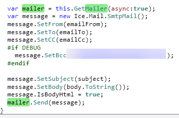

It is sent in BPM how? Do you use widgets with async send or just C# for send mail class?

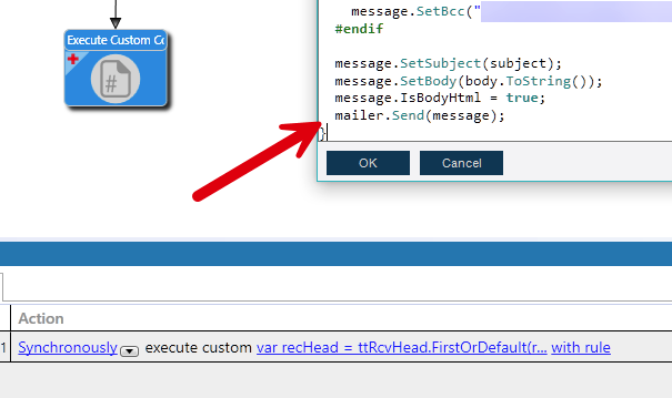

C# to send an email. Go through a bunch of code to build the email, then send it like this. It’s being set synchronously because of bad experiences with async processes in the past (which admittedly may or may not be a problem anymore)
No tasks then. They are only used in async sends…
Here is more relevant code.
Correct. No tasks. But the task agent somehow picks them up and sends them. Which sounds odd now that I say that.
well I see async on your screeen and it is exactly what I am talking about
    public ISmtpMailer GetMailer(bool async = false)
        return async
            ? this.asyncMailerLazy.Value
            : this.syncMailerLazy.Value;
But if you change it to sync, then transaction may wait for it? What DD is that?
It’s on the RcvHead table. I can try and do a test to and change that if you think it will help? The hard thing is I haven’t been able to recreate the issue, it always works fine in my test systems, so I have to catch it in the wild.

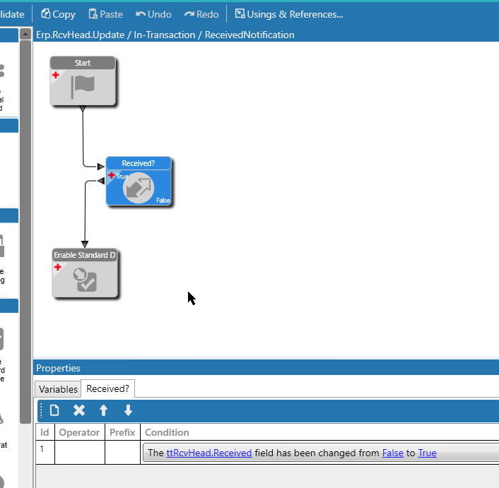

There is an in transaction to enable the standard where the actual code is being fired.

Standard is out of transaction so probably if you set this.GetMailer(), then it will be working fine. But you better test.
So just to verify I understand what you are saying,
Just remove the async? So change this:
  var mailer = this.GetMailer(async:true);
to this?
var mailer = this.GetMailer();
Yes, because the definition is:
Or you can set it explicitly: GetMailer(async:false)
Got it. I’ll test is in Pilot and see if it breaks anything, then if it seems to keep working, I’ll change it in live and monitor for duplicate email.

I guess my only question is why, on a Data Directive, do you have the condition set in the standard directive enabling the in-transaction directive that actually sends the email (or vice-versa, it’s a little difficult to follow along which is doing what)? Why not just place the condition inside the directive that’s compiling and sending the email and do away with that “enable” widget altogether?
The other issue that you could encounter is if the Header is marked as received, and then unchecked to make a correction or add another line, and then rechecked as received again. That would result in multiple emails getting sent out; and would require your receipt entry personnel to be a little more deliberate when they’re entering receipts - only checking the received checkbox when everything is finalized. That’s a relatively common occurrence with both receipts and shipments (and for those who use it, as to why EDI shipment ASN’s are typically scheduled to process at intervals as opposed to the moment when a transaction occurs).
