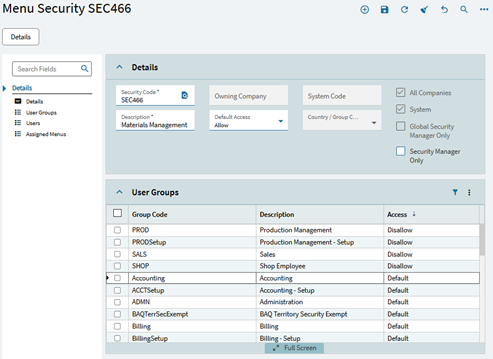

The menu item was attached to a SEC code with the Default Access “Allow” with all, but 4 user groups set to Default. The user belonged in one of the “Disallow” user groups, so the security manager changed the field value from Disallow → Allow. Thus, sparking a huge issue, a bug that I have coined the “Double Positive Error”.
Because the security manager explicitly changed the user group from Disallow to Allow, and NOT Disallow to Default, every group labeled “Default” lost their permission to this menu item. Dozens of users were stripped of their authorization because one user group was granted permission with the wrong method. The complaints rolled in, the change was reversed, and I was tasked with looking into the Why.

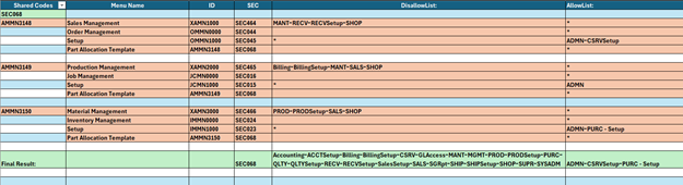

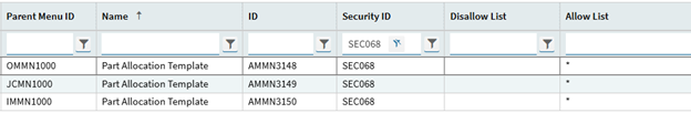

I decided to start tackling the share codes first. Multiple screens can share an SEC code, and the same screen can be stored in any amount of folders. Why doesn’t every unique screen have its own SEC code? Who knows. Regardless - Every path needs to remain open, but all parent folder authorizations need to be carried down to the menu item level. A tricky thing to document. I thought this was the best way to get my bearings.
The SEC Code stated up top, and then each menu item’s individual path below. Having every single Allow list and Disallow list accounted for makes it easier to calculate the final result. I think when the goal is to keep permissions the same, creating the Allow list first is the priority. Reflecting the Allow list result to the Disallow list was a key sanity check while working through these.
In this example “Part Allocation Template” is a menu item that is wide open to any Right Click context menus. Should everyone be allowed in this screen? If not, the parents’ permissions need to be brought down to avoid an unauthorized user from getting in. Currently this screen is vulnerable to a context menu click through.
“Part Allocation Template” is in three different folders. Between the three parent Setup folders, groups ADMN, PURC-Setup, and CSRVSetup need to have access. Resulting in:
  • Allow List = ADMN~CSRVSetup~PURC – Setup
  • Disallow List = The rest
Done. That is the result and should be put in the DMT. This menu item/SEC code is now locked down. (Menu items that only exist in one folder should simply just adopt the parent’s authorizations to be “locked down”)

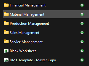

After going through the tedious process of documenting 250+ shared codes, I moved onto creating the DMTs for each system folder. Using the Menu Maintenance structure for organizing the folders made the DMTs a manageable size.
“Personally I like to keep the same menu structure, as this aids the users in navigating when they are using and documentation, like online help or the ELC. The whole, “Setup, General Operations, Reports” after a while you just eat sleep and breath the menu structure.” - @Hally
I ended up with 40 DMTs total when it was all said and done.

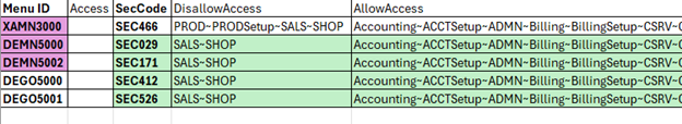

I found it helpful to have two documents for each folder. A “worksheet” that followed the same structure as the DMT, but with Menu IDs listed, and the parent folders/shared codes color coded. Having a worksheet for reference helped me to audit my work and was much easier to read than the plain .CSV DMT file. Storing the completion logs also makes things neat.
(Going to Menu Maintenance → selecting the folder → filtering the menu items in ascending order → exporting to excel) gave me the skeleton of the DMT. There will be repeats as multiple menu items have the same SEC code. I preferred to keep the duplicates in the worksheet and remove them from the DMT. Identifying the shared codes and copying and pasting from the master sheet made the process a lot quicker too.

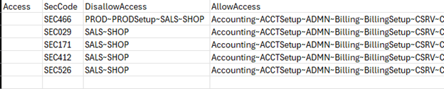

The DMT itself has just four columns:
