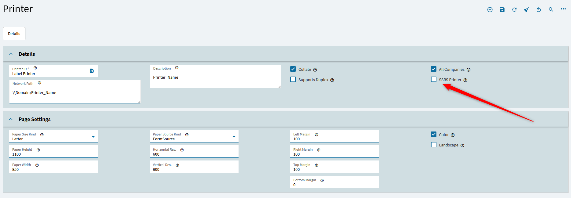

  5. If you don’t want a printer to show up in the Printer List BAQ then you set the SSRS Printer value to True. Also if you are running multiple companies and don’t want a printer that’s in one plant to show up for another then you can uncheck All Companies in Printer Maintenance.

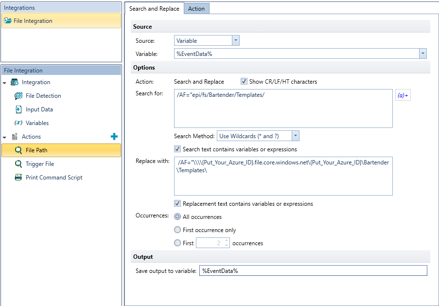

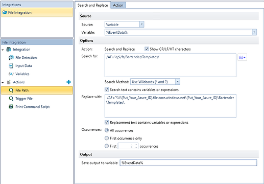

I am using the Bartender settings that Epicor specifies in their setup docs with the following Actions setup:
File Path
Search for: /AF=“epi/fs/Bartender/Templates/
Replace with: /AF=”\\{Put_Your_Azure_ID}.file.core.windows.net{Put_Your_Azure_ID}\Bartender\Templates\
You will put in your own Azure folder ID which Epicor provides.
