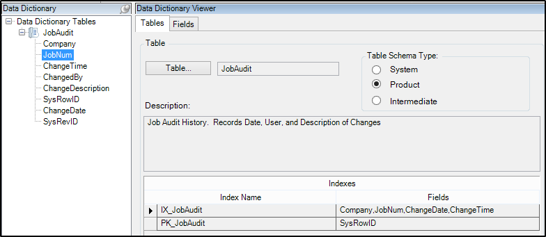

You should be able to get what you need from the job audit log table.
JobAudit ended up having what I was looking for, and due to some custom things we have there is another place I can get it from as well. I will definitely be keeping what you posted in mind for the future though, could prove to be useful!

@cole.trent good to hear. Our audit log is almost empty, so never use it.
