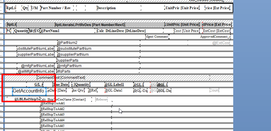

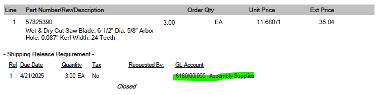

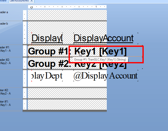

In the crystal version we have it shows a subreport to "getaccountinfo on the G/L#. See images.

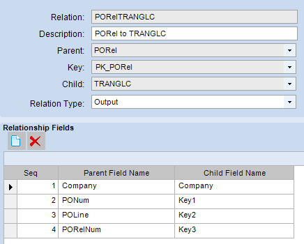

  1. Added TRANGLC as Data Source
  2. Added Relationship between PORel and TRANGLC:

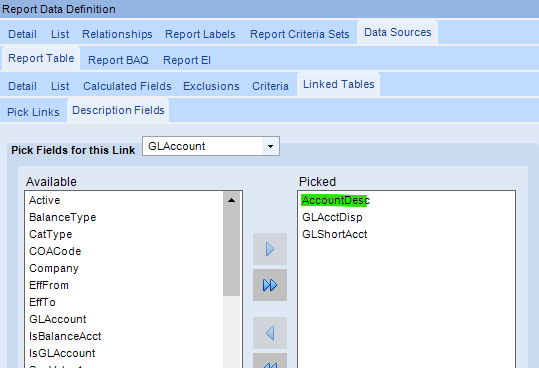

NOTE… if you want the GL Account description, you need to add the GLAccount linked table to the TRANGLC table:

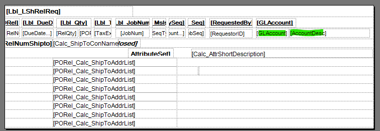

RDL:
I added the below join to the POForm_PORelPart subreport…
LEFT OUTER JOIN TranGLC_" + Parameters!TableGuid.Value + " T5 ON T3.Company = T5.Company AND T5.Key1 = cast(T3.PONum as varchar) AND T5.Key2 = cast(T3.POLine as varchar) AND T5.Key3
 = cast(T3.PORelNum as varchar) AND T5.RelatedToFile = 'PORel'
Added these two fields to the query:
T5.GLAccount, T5.GLAccount_AccountDesc as GLAccountDesc
Added them as query fields:
Added the fields to the report:
Results:
Unfortunately, with this method Report Style \ SSRS Breaking/Routing gives an error:
“Parent Columns and Child Columns don’t have type-matching columns.”
