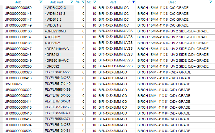

Right now I can sort out the jobs on the scheduling board by the material part but they all currently have dates all over the place for starts. We only run one shift so if I run MRP and scheduling with finite it fills all the current time slots by date and the jobs are very difficult to change their start dates.

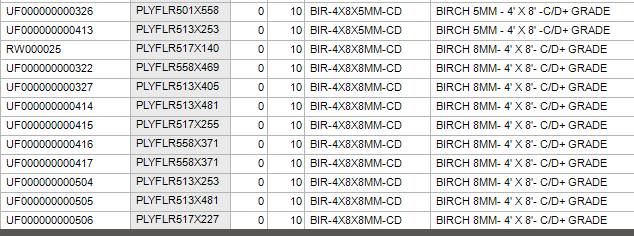

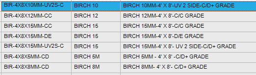

These are the 7 materials that we want to schedule by. We have a number of parts that call out each specific RM and we want to be able to optimize them by material at the beam saw.
So in this example I would want all these to line up in the same week, I know I have the capacity but the scheduling engine has these currently scattered over a month randomly based on need dates. This is where I get confused on how to setup the material as a capability so that in a weekly bucket the jobs will line up in that order
