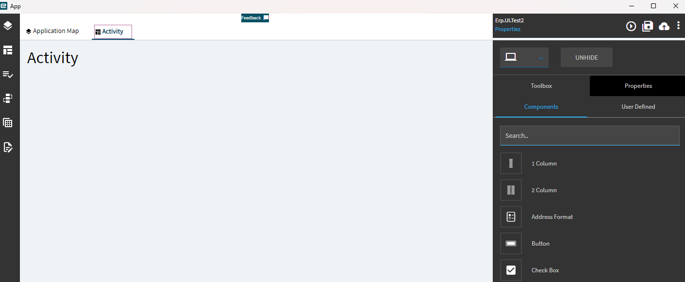

Then I click on Activity and click on “Edit Page”:

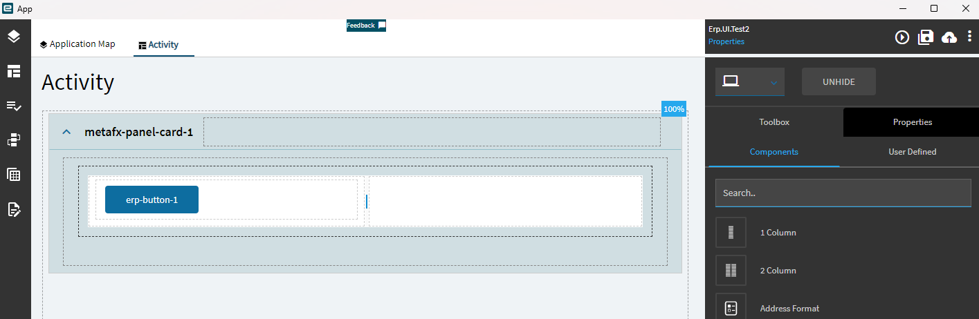

Then I add a PanelCard, and then a 2Column inside the panelcard and a button inside the 2Column:
Then I click save and then click “Preview”:
Its a blank page! I tried those steps on the Detail page and still a blank page. What am I missing?

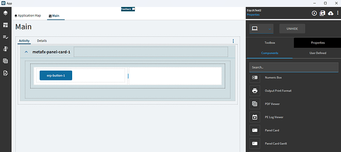

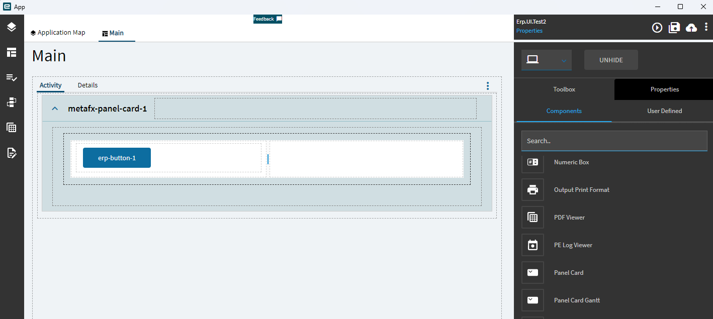

Thanks for your reply! This is what ‘Main’ looks like which you can see the two ‘Activity’ and ‘Detail’ tabs. Also when I try and add a card on main, it just doesn’t add. It shows a preview of where I want to add it but after I drop the card on the Main page, it disappears and does not get added to the page.
Is there something I need to do on Main to make it work?
My guess is the Main, like you’re showing, will show what you have built in the Activity tab.
But, like @d_inman stated, when you preview, your app is opening to the Landing Page. But the Landing Page is not MAIN, it is the (App) page in your Application Map. Do you have anything there?
If you want the application to open up showing the Main page… my suggestions would be to add an event like the below:
So, after the form loads… set the page-navigate-to: Main
@dcamlin thanks for the correction; ‘App’ is what I meant rather than Main. Saving away your event suggestion for future use.
@Samm Sorry for the confusion. Other than on some screens the action buttons/icons, I’ve yet to see where you can do much editing of the ‘Main’ page.
