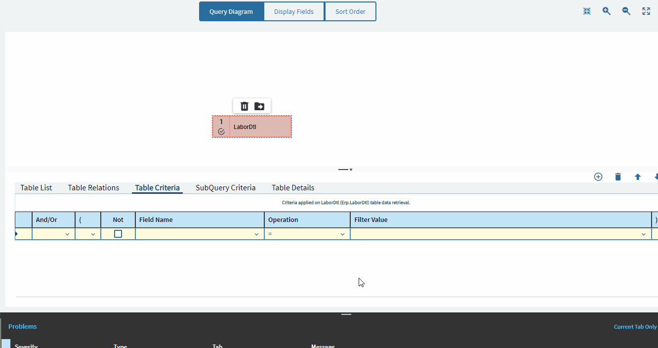

Do any of you get this bug?
1
You have to start typing for the combo to populate
Yes indeed.
But still, think about the fact that you can TYPE there. So much better.
In classic, you just had to memorize that Plant is the 14th field in PartTran that begins with P.
PPPPPPPPPPPPPP
:point_up: That’s the quick way to get to it.
JobFirm was the 9th J in JobHead.
Yes I still have the scars.
IIIIIIIIIndeed, def a step forward!
All the time. There’s an even worse bug than that. If there are two fields that start the same way, you CANNOT type to the second one. It sticks on the first one it finds and refuses to accept even if you type in the full name of the field you are actually looking for. Then all you can do is scroll and scroll and hope you find it eventually.
