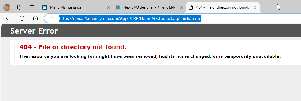

This isn’t working for me:
I also tried to create a new menu item like you show above but I can’t enter the ‘studio/baq’ URL. That box is disabled.

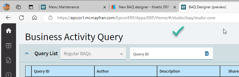

You are missing the name of the instance (ie Production) in your URL.
https://host/instance/Apps…
