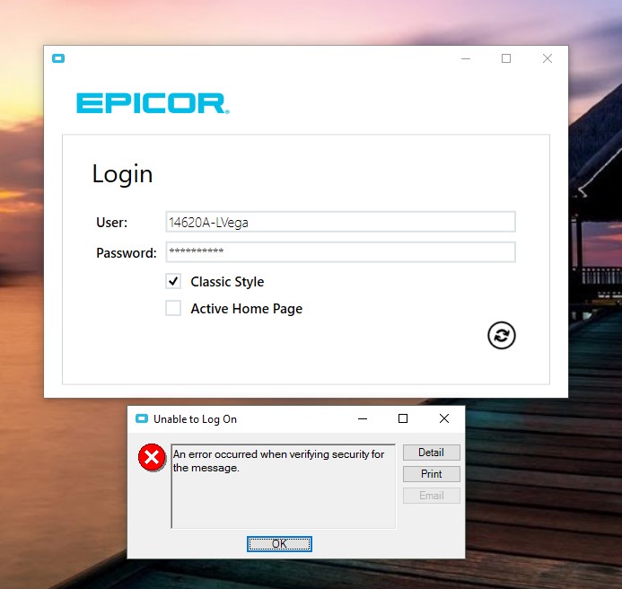

I just installed a new Epicor on a new computer, as one of my users try to sig in, the following error appears:
Any advice?

Click on Detail and Paste us your Stack Trace.
Make sure the time on the PC is the same as the time on your Epicor server, or as close as you can get.

The detail sheet is empty.
The Epicor server time is always 12:00am
Trigger the Error again! then
Launch Event Viewer somewhere located within your Start Menu…
Navigate to the Administrative Events and look for anything related to Epicor, it should have more details there which you can send us screenshots of.
The Epicor Server time can’t always be 12:00 Am…
