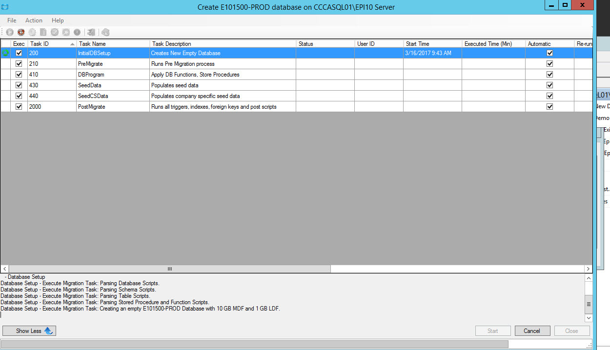

New Installation of 10.1.500.14 and added Database

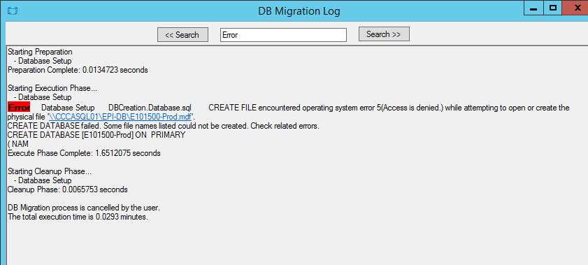

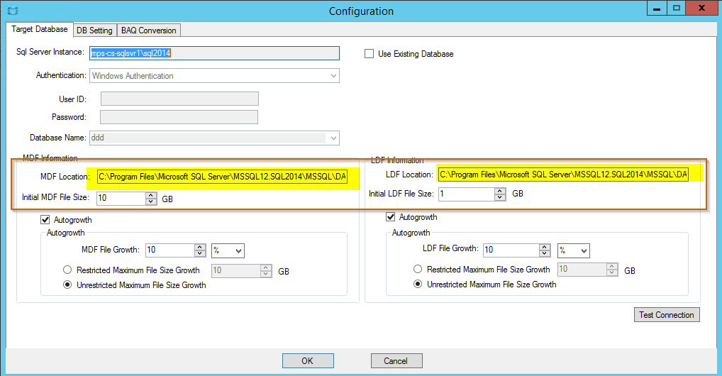

WHen I add the database, it only allows me to add to the default location for the MDF and LDF, which is in the C directory.
When I change the path I get a Access Denied, that it cannot create the files in the path. I am able to create a text file remotely, the drive and folders are shared since I am able to create the file.

It appears that you’re trying to use a UNC path for the .mdf/ldf which wouldn’t be recommended for a few reasons and would ultimately require changing the user account that starts the SQL server service.
Within the EAC’s create database window, click Actions > Configuration.
If you change the MDF and LDF location to the absolute local paths on the SQL server (e.g. d:\mssql\data and e:\mssql\logs), does that allow you to successfully create the database?

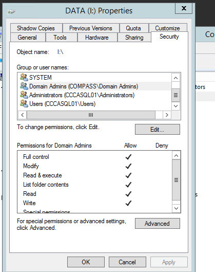

I even created a new directory and gave EVERYONE full access.
I created a local account as well
Are you a domain admin? What level of permissions does the SQL account you are using have? What type of drive is this iSCSI or DAStorage or internal? In windows everyone permission does not always mean everyone, you sometimes are contending with NTFS vs Share permissions. Is this drive that you get “access denied” on a shared drive and if so what are the permissions there and if it’s hosting your MDF and LDF why is it shared?
Yes to all the admin rights. Some say I have too much access. :slight_smile:

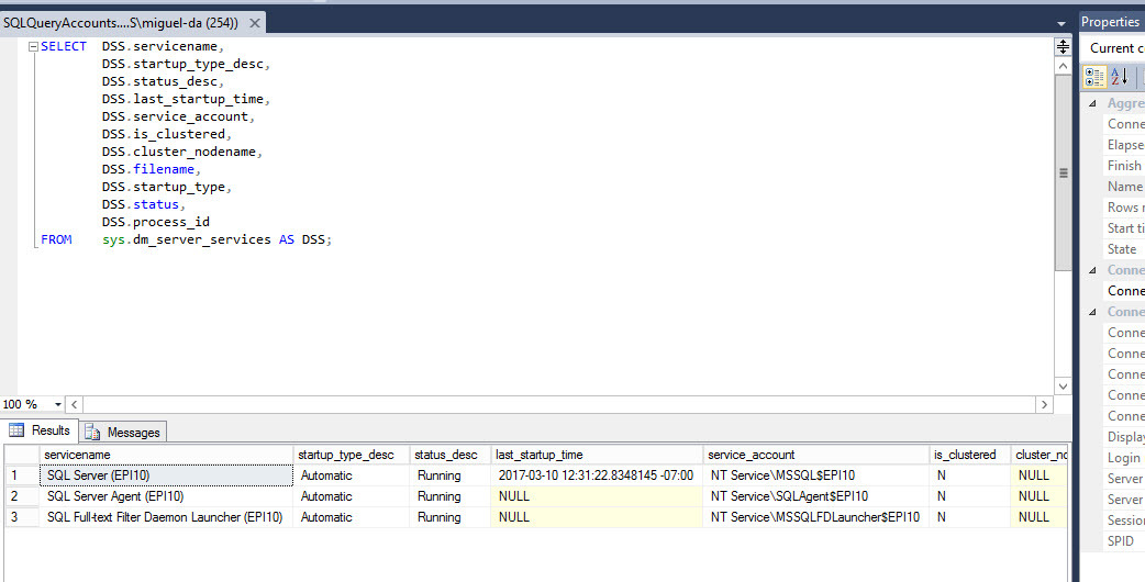

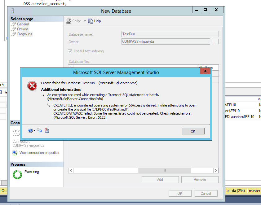

I am using my domain account to create the DB. I have also tried using the sa account. Any thoughts on the SQL side what it could be.

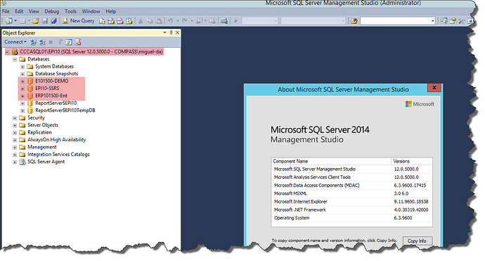

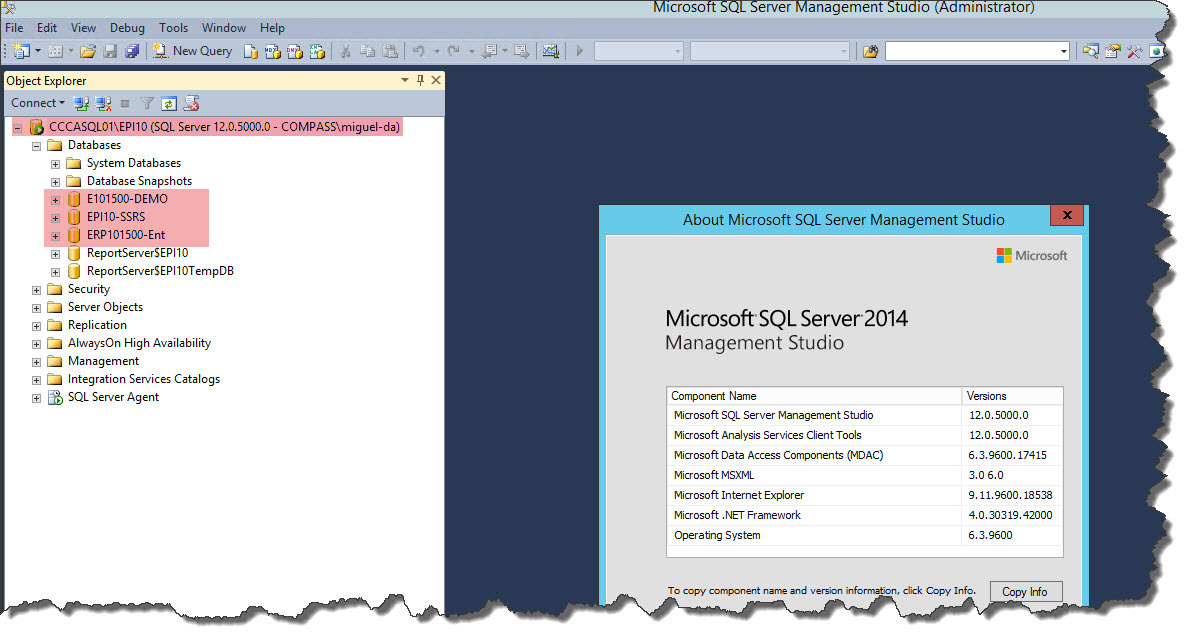

are you doing this from a remote pc/server and do you have sql management studio for 2014 installed on whatever device you are doing this from?
Epicor Application is on CCCAEPI10 VM server
SQL is installed on CCCASQL01 VM server and can connect to the CCCASQL01\EPI10 instance with Studio 2014
I can create the DB on the C:\ but not on the I or L.
And within Management Studio on the actual SQL server you can’t, as SA, create a database on a drive other than C?
Could be a permission issue on the Service Account.

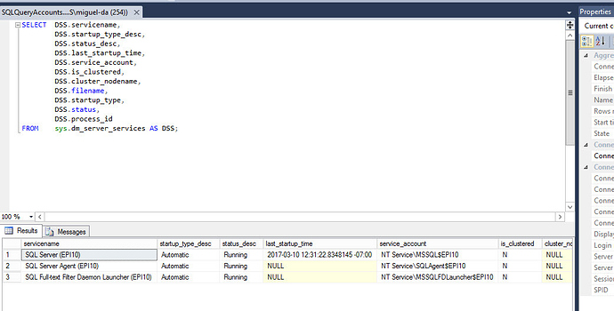

I needed to add MSSQL$EPI10 to the security and I finally figured out that I need to put NT SERVICE\MSSQL$EPI10.

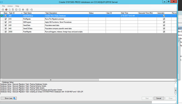

I am able to create a Test DB now and also use EAC to create the new database.
