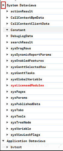

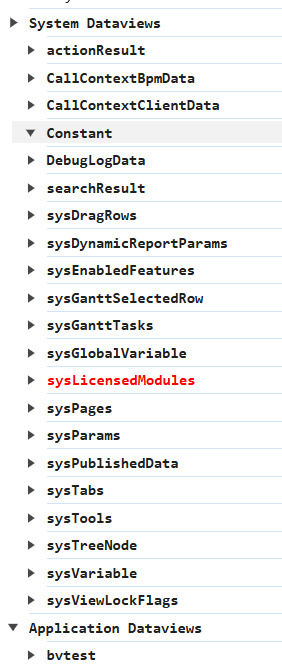

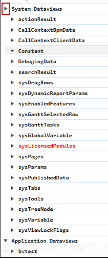

And I noticed, when debugging, I pressed CTRL-ALT-V.
All the system dataviews show empty.
I was looking at Constant, specifically, but it’s happening to all of them.
They aren’t actually empty, but you can’t see them anymore.
This proves they aren’t empty epDebug.dumpViewData("Constant").
That works and shows them.

Let me know so we can gang up and get this reported properly.
Did not see the issue - was on quote screen, firefox
EDIT: Also fine on a dashboard.

When I saw this happening before I think that it was a client side issue, maybe extensions doing some mangling. But different browser or incognito worked for me when it crept up on me.

I noticed the same, but I found out that after you click the arrow in front of ‘System Dataviews’ and then expand any of the dataviews it does show data.
