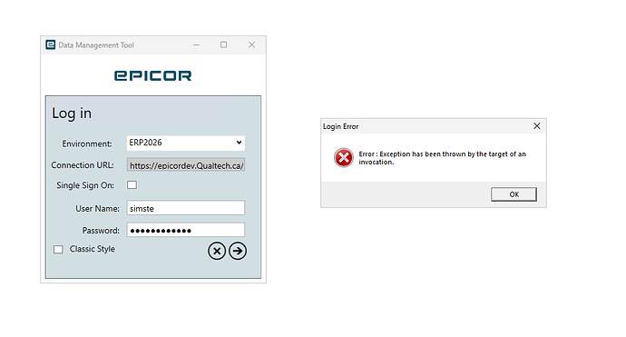

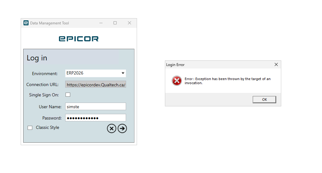

I have this error on login but I don’t know at all how I can search for an error ?
I tried to run it as admin and still not working
I compared to another DMT.exe.config file (From a 2025.2 environment) and it seems similar so I don’t see why this new environment in 2026.1 doesn’t work

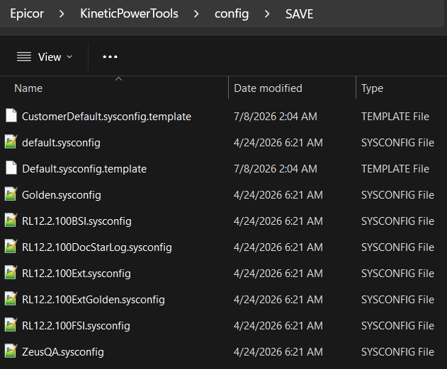

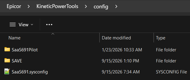

I had a ticket with Support for this issue. It is the incorrect environment. The fix provided by Support for me was to remove all the incorrect sysconfig files in \<powertoolsinstalldir>\config to another folder (e.g., “SAVE”).
So in my \config folder, there is only the one legit sysconfig:
In the \SAVE folder are all the incorrect ones:
Support said that these were all just left over from development testing, so they have no business being there. Development needs to clean up their stuff before they ship product!
