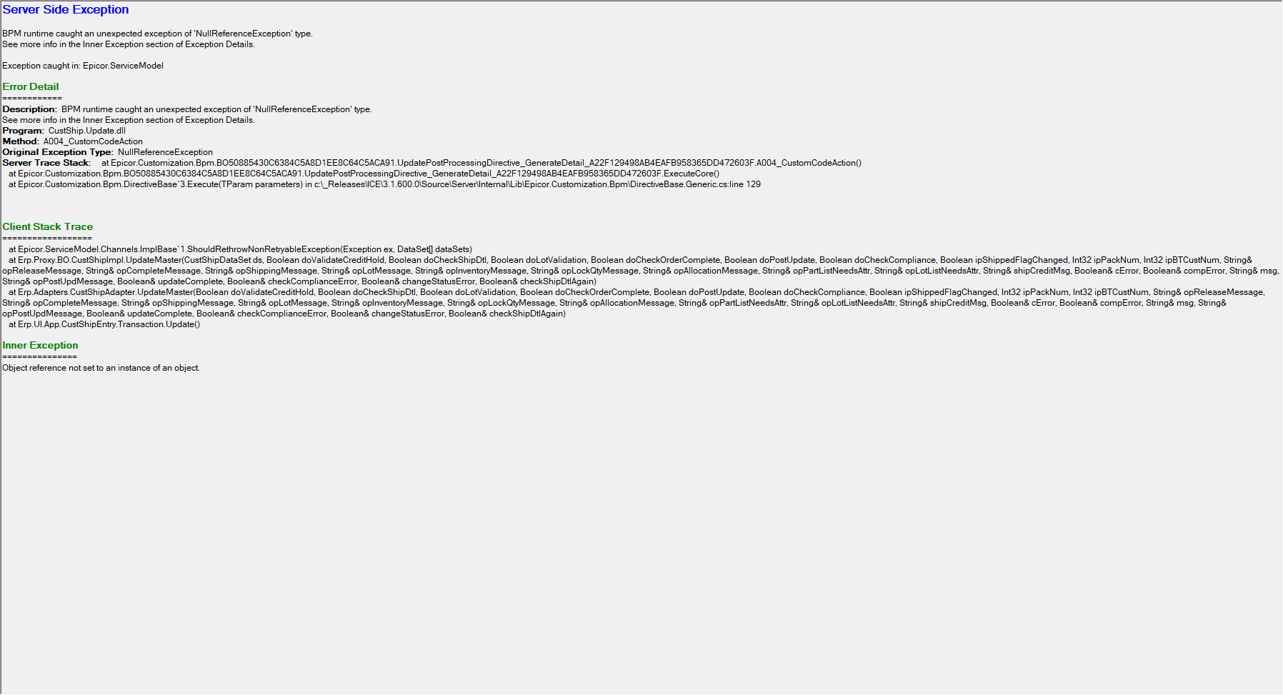

I get the error when create new ship detail in shipment.
please check error and code below
#error
#code

Are you sure the pack no. 4206 exists in your system ? I would get rid of that.
sure bro,
Please see a picture below
Ok, if there aren’t any changes in the ShipHead dataset, then the ttShipHead will be empty. Which is what I think happens here. Not sure why you need that first piece with myShipVia but if you still want to do that I would get the val from the DB instead of the temp table. Like replace ttShipHead with Db.ShipHead

I tired after try many ways to resolve it use BPM, but I do some trigger in customizations to pass the parameter and it worked.
