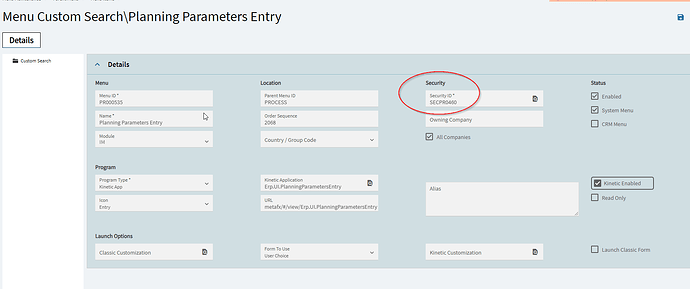

You have to implement security on this:
Thanks for the quick response. In Menu Security Maintenance, I can set that as Disallow or Default Access = None. But then the user cannot View the Planning Parameters at all. It doesn’t just say ‘you can make the change’ it says ‘access denied’ even for viewing.

Can disable the planning parameters fine using the Menu Process setup, cannot seem to find a way of disabling the Process MRP or Generate Suggestions from the Ellipses menu or are they based on the User Security for the main Apps?

I thought I’d try “Read Only,” but that does not, in fact, make it read only.
If I had to guess (because I have to guess), it’s due to the app-open calling the app, not the menu ID.
Menu security is kind of OK for this. But I feel blindsided by it all.
Yes, menu security worked in my test for MRP also:
