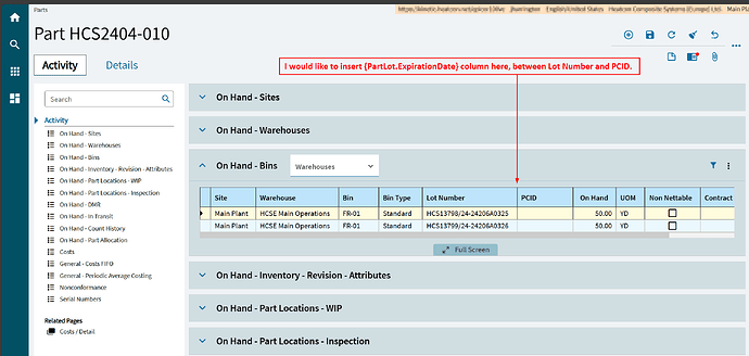

New to Kinetic: Best Way to Add Custom Column to Panel Card Grid?
I’m trying to add the ExpirationDate column from the PartLot table to the Panel Card Grid entitled “On Hand - Bins” of the Part Maintenance Activity screen (see attached screenshot).
I’m still fairly new to the Epicor Kinetic UX and Application Studio, so I’m not sure whether I should modify the existing panel card or take a different approach.
Any guidance on how to accomplish this would be much appreciated!

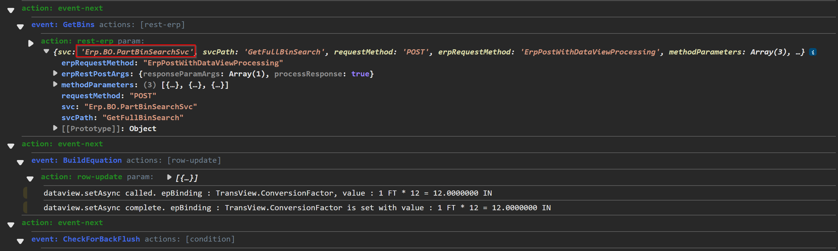

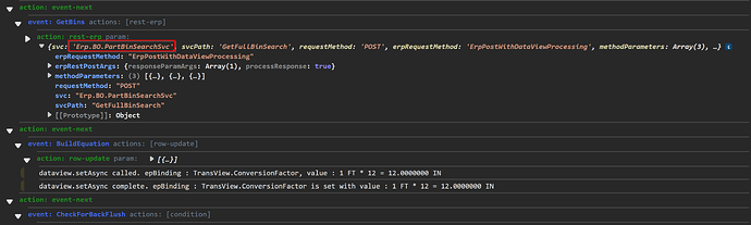

I’m using the Edge debugger (see screenshot) and identified that the service being called is Erp.BO.PartBinSearch. Based on that, I’ve started creating a post-method directive for Erp.BO.PartBinSearch.GetFullBinSearch.
I’m still new to working with C# in directives, and after looking through the example code provided (thanks for that!), I realized I’m out of my depth. I’ve got basic C# knowledge, but haven’t had much hands-on experience with it in Epicor’s customization layer.
I may need to hit pause on this piece until I’m more confident, but if anyone can help clarify what this kind of directive typically looks like or offer pointers for how to approach modifying GetFullBinSearch, I’d really appreciate it.

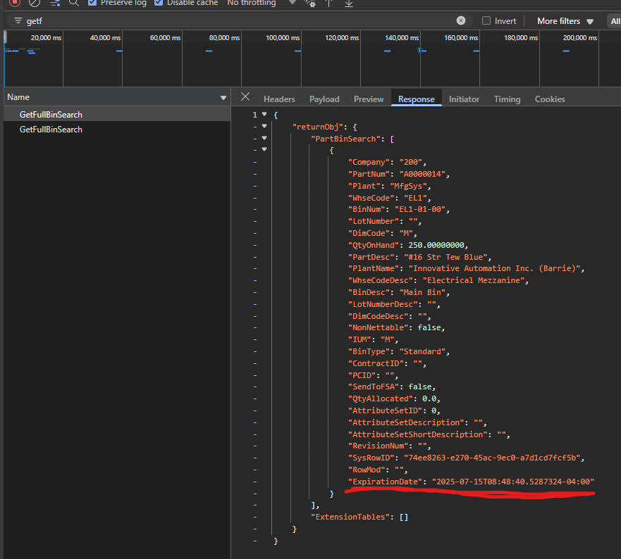

You are on the right track. A post processing directive on GetFullBinSearch will work.
Your code will look something like this:
foreach (var row in result.PartBinSearch)
    row["ExpirationDate"] = DateTime.Now; // Replace with Query to get actual expiration date
Once the BPM is enabled, you should see the field be returned in the dataset
Then you just bind the field up in app studio

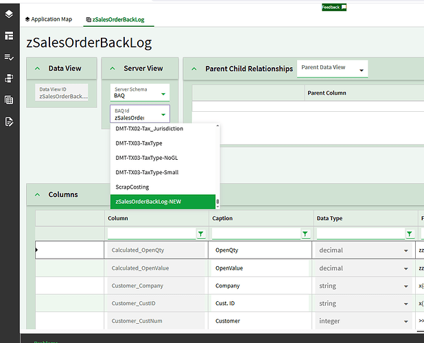

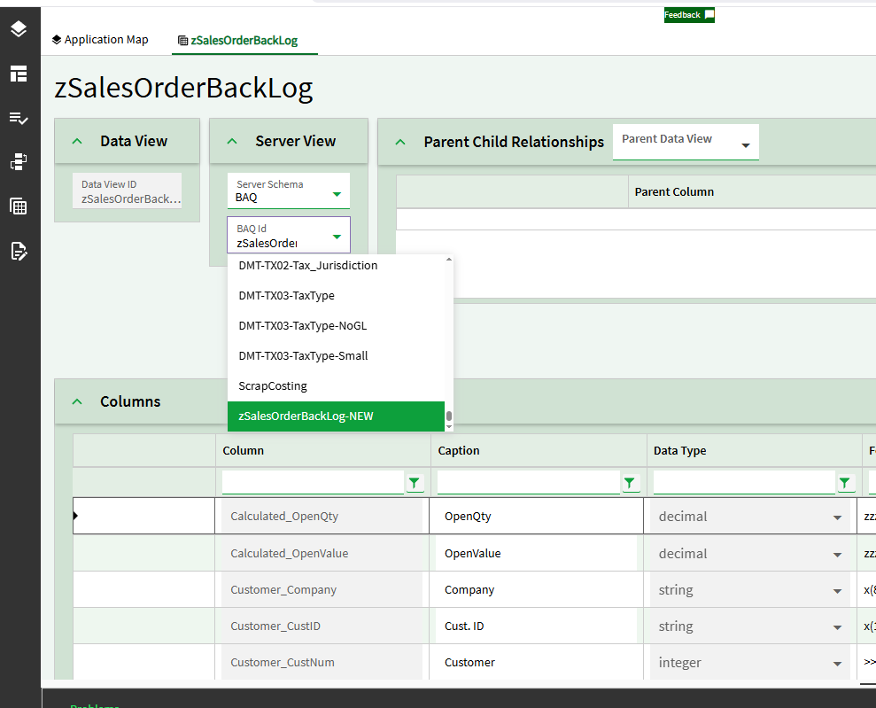

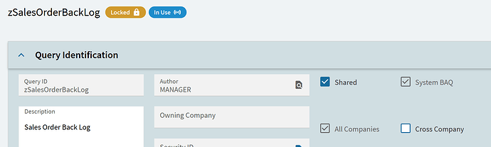

My problem is that zSalesOrderBackLog is a “System” BAQ, so I can’t edit it. Is there any way to work around that?
You can copy it to a new BAQ then change BAQs on your dashboard layer
I guess that’s where I’m stuck then. I have no problem changing which BAQ to reference in a custom dashboard, but I tried doing that in this system dashboard and couldn’t get everything to match up (the filters and connected tables).
I think the Events in AppStudio are hidden from me because of that, so I might have to completely rebuild the dashboard as custom just to add 2 columns to the grid :frowning:

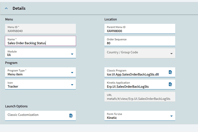

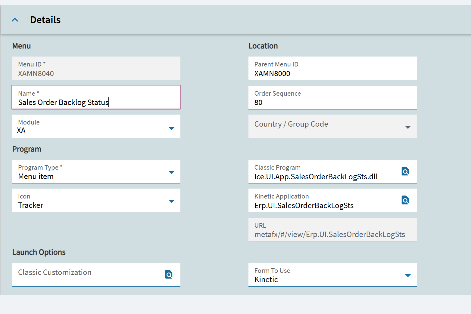

The dashboard is part of the CRM module: Erp.UI.SalesOrderBackLogSts
You can change the BAQ in the DataView like so:
Then add the column to the gridModel.columns
:sweat_smile: Thank you for pointing that out. Here I’ve been adding a new data view and trying to remap everything :face_with_hand_over_mouth:

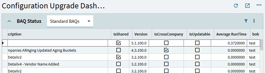

Result, added columns to Grid bound to ExecuteBaq on base layer, no layer customization needed, only BPM:
Base Layer:
