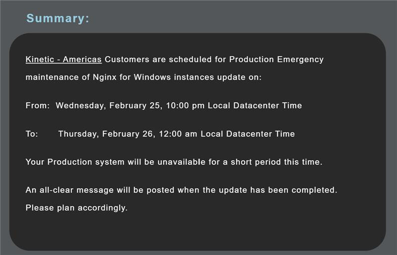

We are having issues with our BAQ APIs starting yesterday after an update from Epicor.
Immediately after this was marked resolved, our BAQ API started failing.

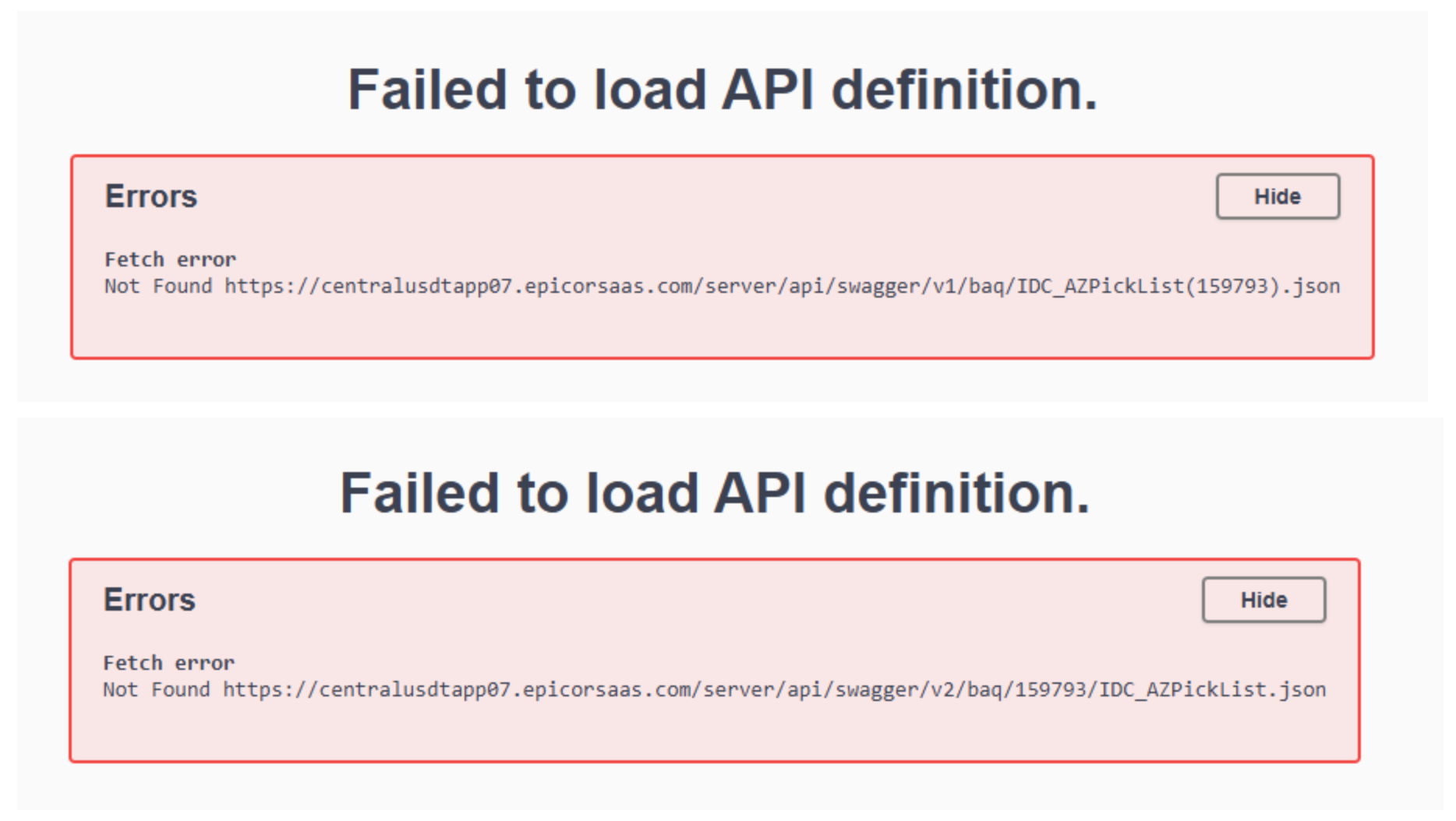

Hi, I think the URL that is being returned there may be an indicator.
.../SaaS576/... is your production URL.
/SaaS576/ in the URL path is replaced by /server/ there, i’ve seen this issue happen in the past and it needed an epicor ticket to resolve.

Our BI API connections started failing with redirect errors due to this update. We were told to use this format as a ‘work around’. No word on if this is a long term fix or not.
The REST call calling BAQs need to use the following format as a workaround:
Https://[KineticServer]/[KineticInstance]/api/[VersionNumber]/BaqSvc/[BaqName]/?[baq-param]=x&[baqParam2]=y
