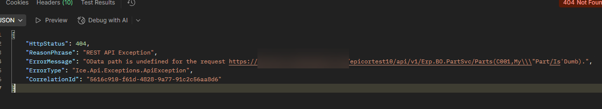

There was another post on here about Odata breaking following the change to Linux. Epicor has a NGINX config wrong. May be causing your issues.

So I was able to fix our apps with changing the URI to this:
https://idcspring-live.epicorsaas.com/server/api/v1/BaqSvc/{BAQNAME}(CompanyNumber)
All of my API calls are working again.
Think that’s what @GabeFranco was talking about too. The URLs changed at some point.
