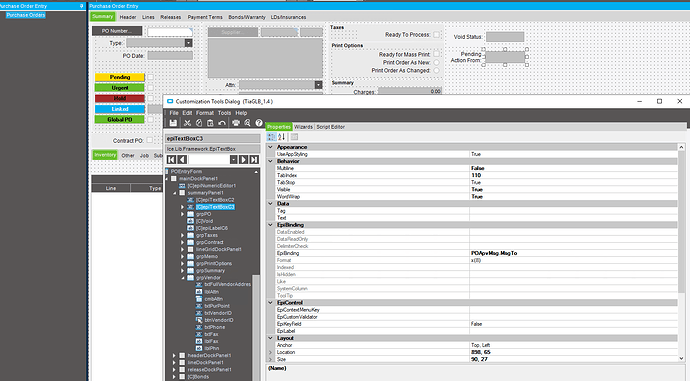

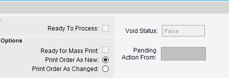

I’m trying to customize a textbox to display the next approver person.
I’ve tried to create a simple textbox and made a EpiBinding to POApvMsg.MsgTo.
However, no data is being displayed. The PO is in pending state with valid msgto data.
Did I missed out anything or am I off track entirely.

Can you show your code?
Hi Steve,
I created the textbox and assigned the EpiBinding to it with no code.
Thanks and Regards,
ChunKit
Not sure if POApvMsg is the active view here… Are you sure you are binding to the correct view?

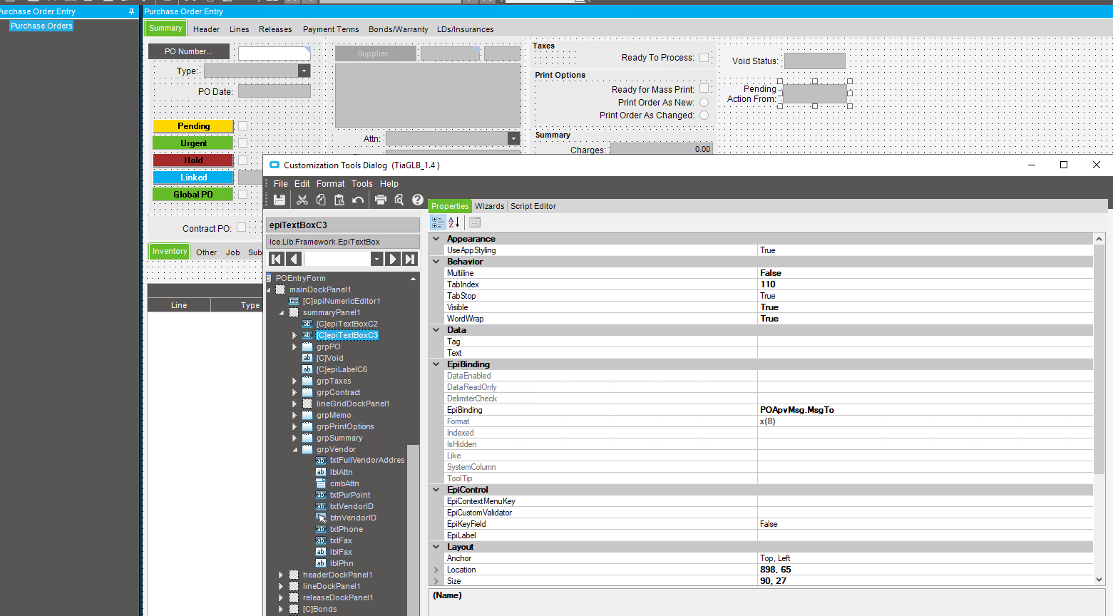

not quite sure about that, now i’m getting this.
Application Error
Exception caught in: System.Data
Error Detail
##!Message:##! MsgTo is neither a DataColumn nor a DataRelation for table POHeader.
##!Program:##! System.Data.dll
##!Method:##! get_Item
Client Stack Trace
at System.Data.DataRowView.get_Item(String property)
at Ice.Lib.Framework.EpiTextBox.oDataView_EpiViewNotification(EpiDataView view, EpiNotifyArgs ar)
at Ice.Lib.Framework.EpiViewNotification.Invoke(EpiDataView view, EpiNotifyArgs args)
at Ice.Lib.Framework.EpiDataView.OnEpiViewNotification(EpiNotifyArgs e)
at Ice.Lib.Framework.EpiDataView.InnerNotify(EpiNotifyArgs args)
at Erp.UI.App.POEntry.Transaction.GetPOData(Int32 poNum)
