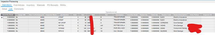

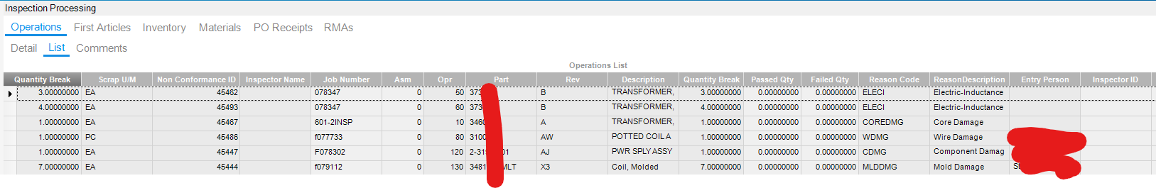

Recently started getting complaints that for some records in inspection processing are missing an “Entry Person” in the list. At first I thought maybe the employee listed on the nonconformance record may not have been linked to the UserID that needed to be displayed here but that doesn’t seem to be the case for the rows that are filled either.
Is there some method I’m missing where an operation can show up here in Inspection processing without an Entry Person being recorded?
