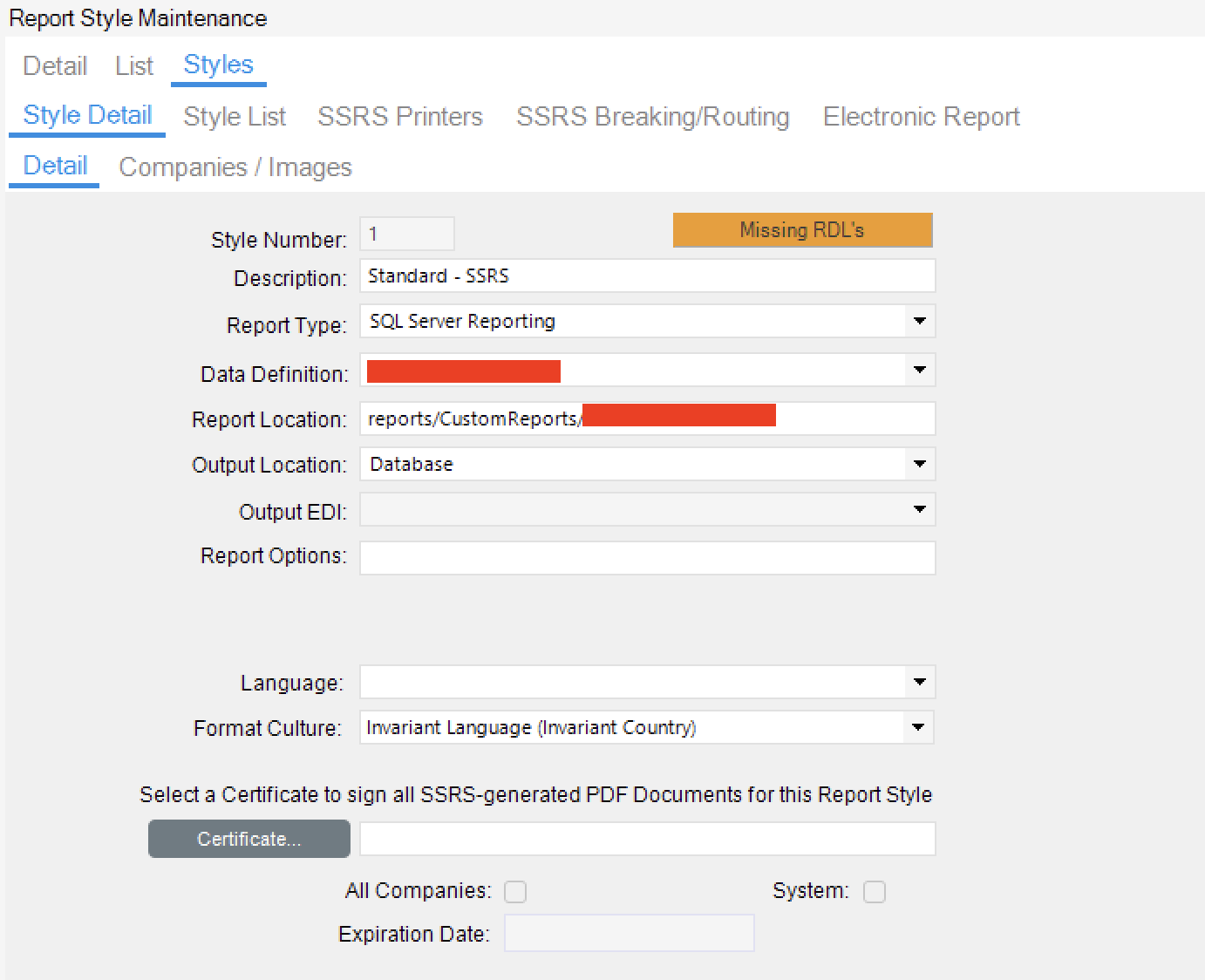

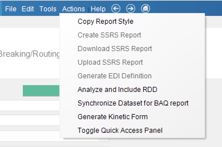

Then I looked at Report Designer and there are no crystal reports or SSRS reports attached to the current report. Yet when I print the current JobMtlDtl, I get a report that looks like a SSRS report. I thought maybe, it’s pulling a SSRS report from a default report in Epicor but I got nothing.
What am I missing? There is a report somewhere it’s calling on.
Click on the “Missing RDL’s” box. Does it update?
I did that and it switched to Ok and green but still no SSRS report to download.

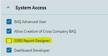

Do you have this checked on your User Account record?
I knew it was something simple.
Issue was, the report is old and in a different user account so I went in with that user account. Which didn’t have that option turned on. I’m guessing that option didn’t exist when that user existed or for some reason someone unchecked it.
