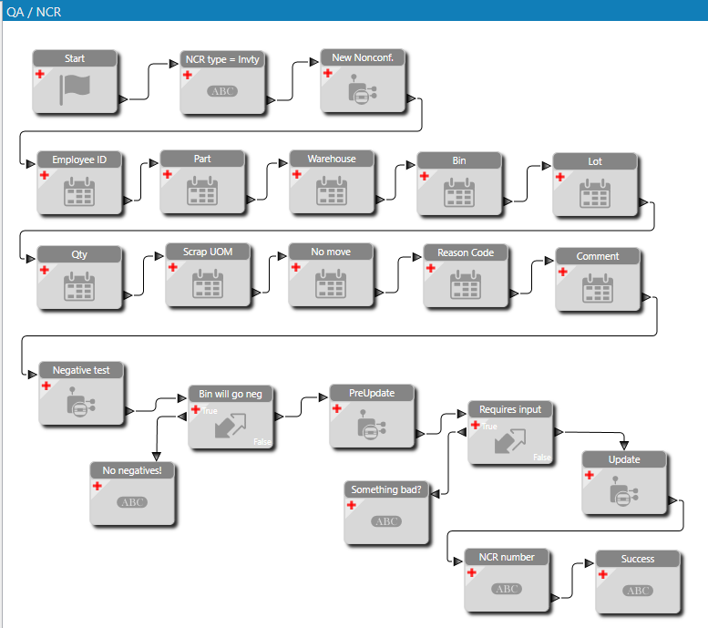

Reason for this discovery is that I was working on an Epicor Function to create a Nonconformance. (It’s done and working now.)

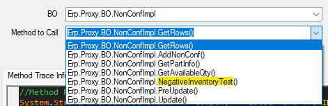

I traced the UI and the DMT. I started with DMT, since I thought that would be nice and streamlined.
Well apparently DMT and the UI use different BO methods for checking for negative inventory.

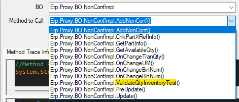

  • DMT uses NonConf.NegativeInventoryTest
  • UI uses NonConf.ValidateQtyInventoryTest
So I made my EFx with ValidateQtyInventoryTest and that has worked well in testing, even when I tried to confuse it with odd UOMs.

DMT trace:
UI trace:

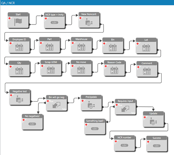

For @klincecum and @josecgomez since you all love widgets, here is what it looks like.

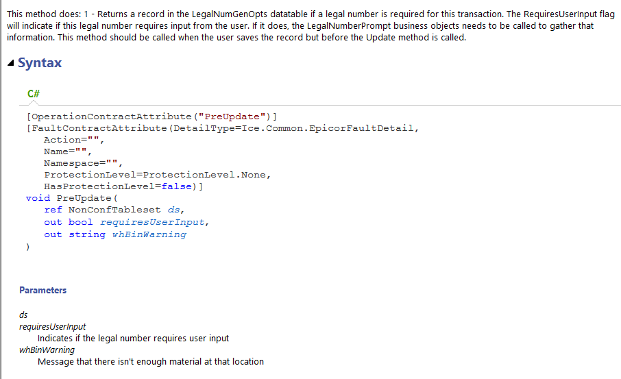

As a side thought, I am curious what requiresUserInput on PreUpdate is for:
I assume it does something so I handled it here:
I guess I’ll find out once it is in Production…
OK cool, thank you.
Is that on the Swagger page?
This is from the 10.2.700 BO tech ref guide which can be downloaded from Epicweb
