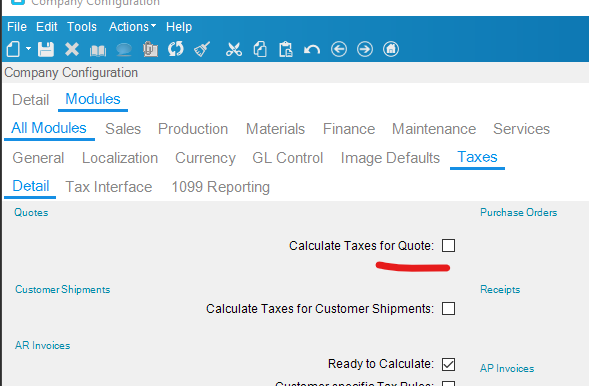

I just refreshed our training database using Epicor’s instructions. One of the first steps to the System Flow tutorial says to go to Company Configuration and check the check box for Calculate Taxes for Quote under All Modules – Taxes – Detail.

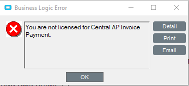

We do that and then try and save but we get the following message.

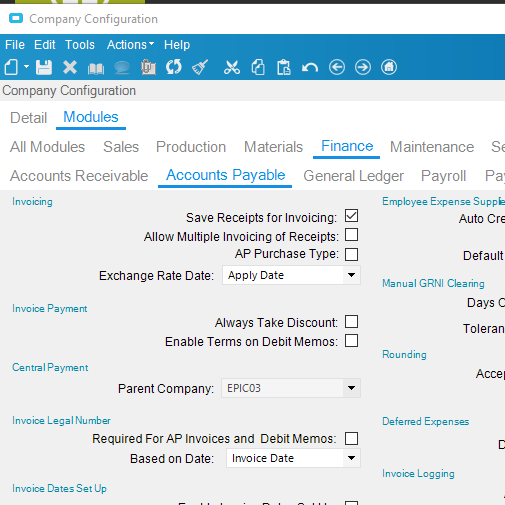

I go to Central Payment and this is what I see.
What do i need to do to get past this? I have a ticket with Epicor right now but they have not found a solution. This is the demo database the is supplied with Epicor.
Joe, did you apply your license key to the Training Db in the Admin Console?
Yep.
The Licensed list gets refreshed when you login. It’s on the Session object. Once you apply the license to the companies in Admin Console, you should only need to logout/login.
All it checks for is
if (!String.IsNullOrEmpty(ttAPSyst.CPayCompany) && !Session.ModuleLicensed(Erp.License.ErpLicensableModules.ConsolidatedPayment))
If you don’t have the CPay license then force-blank out the CPayCompany and it should stop complaining. That may be SQL. Since the RowRule makes it readonly again since your license is not licensed, but their demo database comes pre-filled in… #BugInDemoDatabase

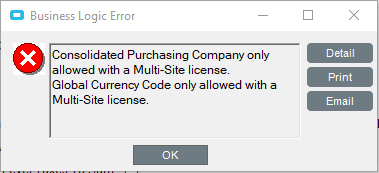

Now I have a new issue when i try and save.
Cleared both of those fields too in sql. Now we are able to make the recommended change as per the tutorial. :thinking:

There is 1 more field you must clear
XbSyst.ConsPurchasingParent
this holds a Hash it generates.

What does this one have:
XbSyst.ConsolidatedPurchasingCompany
That value triggers your above exception
if (!String.IsNullOrEmpty(ttXbSyst.ConsolidatedPurchasingCompany) && !Session.ModuleLicensed(Erp.License.ErpLicensableModules.MultiSiteManagement))
Demo database had EPIC03. Our production database, nothing.
