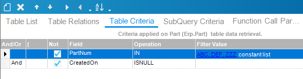

I often find myself debating whether to use not =, or <> in my BAQ condition expressions. Is one method better than the other? Is one used for some variable types and not others? Why choose one over the other?

How do you do
NOT… IN
or
NOT… ISNULL
without it?
Oh, I use it, but I don’t think to look there because I do it so rarely. When troubleshooting others’ BAQs I never think to look at that on any of the criteria.
