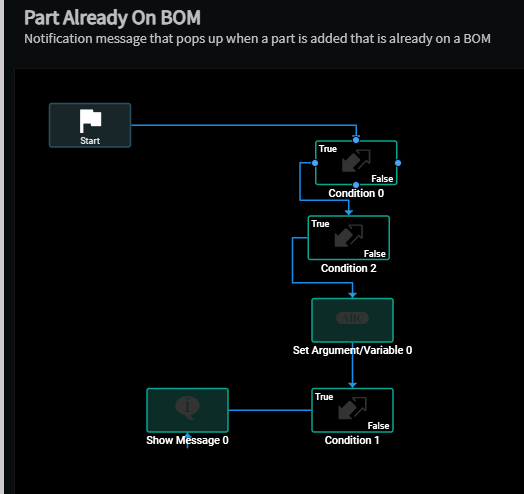

I am working on creating a method directive that shows a pop-up message whenever a PartNum is added to a BOM that is already on there. It should still allow the user to add it, just notify them of this occurence.
The following was my crack at it:
  1. Condition: There is at least oneaddedrow in theds.ECOMtltable
  2. Condition: dsECOMtlRow.PartNum == dsECORevRow.PartNum & dsECOMtlRow.RevisionNum == dsECORevRow.RevisionNum
  3. Set Variable: Set the [MtlPartNum] argument to the [dsECOMtlRow.MtlPartNum]
  4. Condition: TheMtlPartNumargument/variableis equal to the dsECOMtlRow.MtlPartNumexpression
  5. Show Message: “Part number is already listed in the BOM .”
It currently shows the message, but shows it regardless of whether the part is already on the BOM or not. I believe I need some way to directly reference the table of materials for the rev being used in the BOM.
Any help/guidance is greatly appreciated!
Here’s just a few things I noticed:
First, just for future reference, any table joins between ECO tables should include the GroupID and AltMethod. Once you have multiple groups working on the same part, it’ll cause headaches if a material was added in one group, removed, then added again.
Second, what happens when they update a material’s part number? No message will be displayed in this case since you’re only checking added rows. If that’s intended, then you can ignore this bit.
Third, what you’re essentially doing is comparing the same ECOMtl row with itself. When you set the MtlPartNum, the next condition is checking if the part number is equal to itself. What you’ll want to do is compare dsECOMtlRow against all other ECOMtl rows in the database where the MtlSeq key fields are not equal.
How would you go about comparing dsECOMtlRow against all other ECOMtl rows in the database where the MtlSeq key fields are not equal?
Easiest way is to put a custom code widget after Condition 0 when true. I grabbed some code from a similar BPM I have in place already and tweaked it a little for your use case.
Make sure to change Condition 0 by adding a new line, set it to “The specified field has changed from any to another”, and select the ds.ECOMtl.MtlPartNum field.
