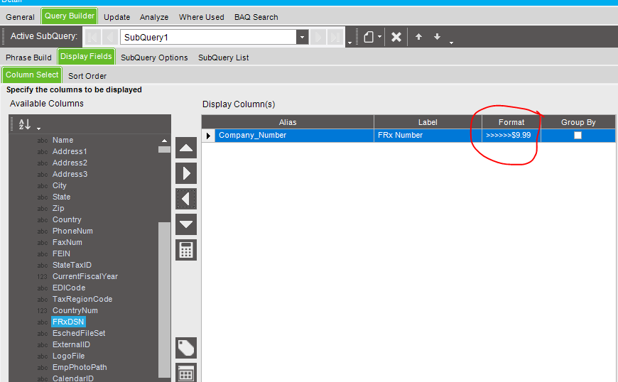

Is there a way to control the formatting of numbers in both Epicor Data Discovery views and in Epicor Dashboards? For example, can you have summed up dollar amounts consistently display with a $ and two decimal places for the cents?
Thanks Adam. I tried that and the numbers show up in a grid view with the dollar sign on a dashboard, however when summed up on a chart view, they do not show the dollar sign and the axis does not have a $ view.
I have not found a way. EDD is really limited in it’s options.
