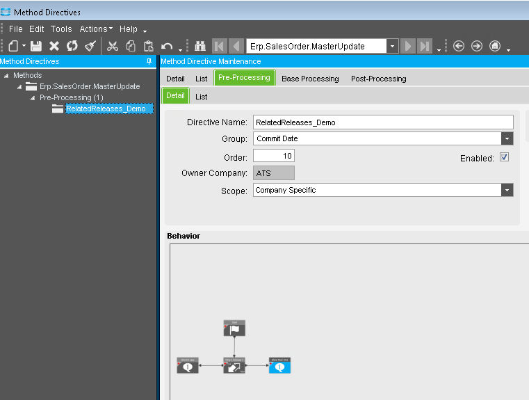

I have setup a Pre-Processing BPM on the Erp.SalesOrder.MasterUpdate Method…
The design looks like this:

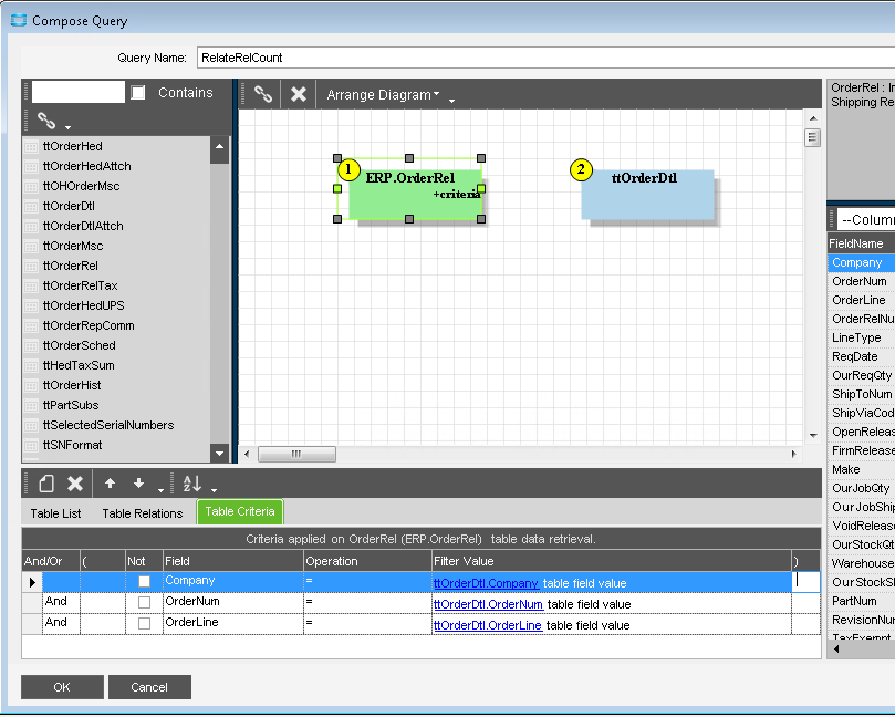

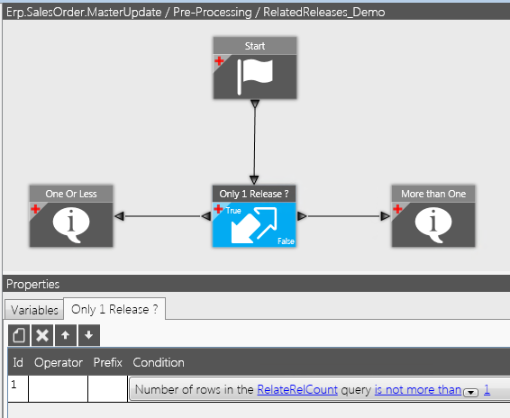

At Insights this year, I learned NOT to create joins between ttTables and ErpTables for performance reasons. Instead, the best practice is to put the ttTable on grid so that you can access the values on the ttTable for Table Critera on the Erp Table like I am doing here…
As you can see, am using the criteria from the ttOrderDtl table to find the related Erp.OrderRel records.

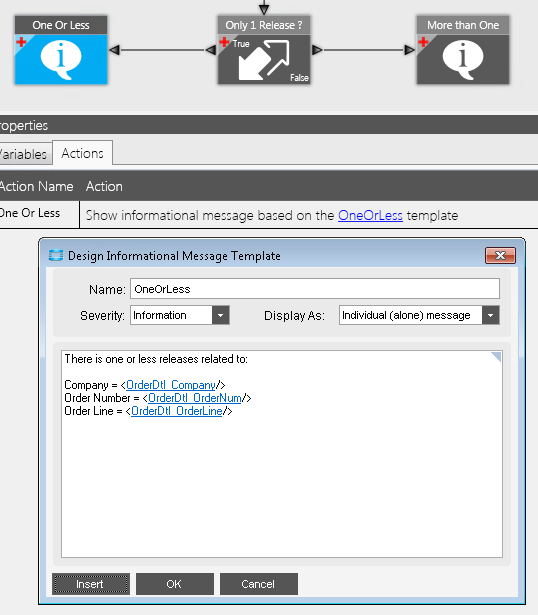

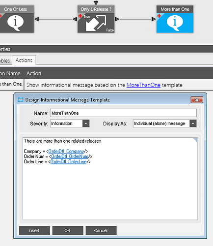

I have a message for the TRUE result…

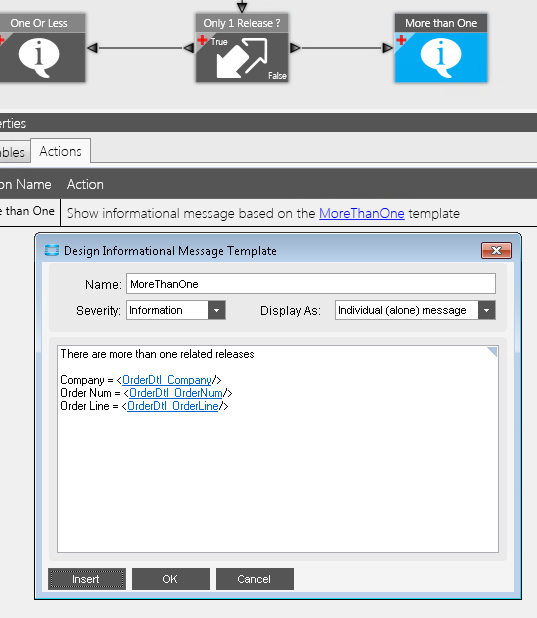

And a message for the FALSE result…
So, to review: the TRUE condition means that there is one release, and the FALSE condition means there is more than one release.

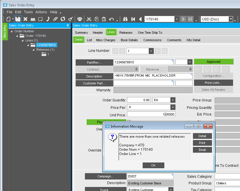

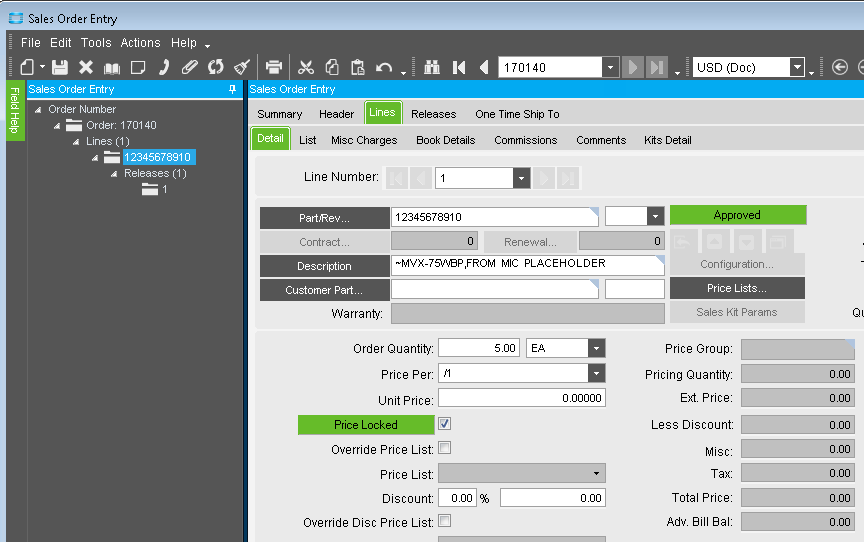

I create a sales order with one line and one release…
When I make any change to the line, the BPM is triggered and the FALSE result message appears, indicating that there is more than one release.
There is only one release, so the TRUE result message should be shown.

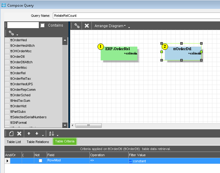

well, you might be counting rows that are both modified and unmodified since you are doing this as a pre-process… In order to filter that down, you need to check RowMod (Try addint a criteria ttOrderDtl.RowMod <> “”). Also you might want to display the rowmod (temporarily) in your popup message.
Also, the join between the tt record and regular database (see other discussion) problem… in order to elimnate the problem, you have to completely REMOVE the TTRecord from the query… this would not work for this particular query since the tt records COULD have multiple lines that changed. I am still working out the recommendation for when there are multiple modified records.

You are correct, sir, it was the unmodified row that was causing the issue. As soon as I put the constraint on the row mod value on the ttOrderDtl table, the query works as expected.
This is not intuitive as the two tables are not connected in the diagram and the “target” table, ERP.OrderRel, does not have a queryable RowMod value. I suppose that using the ttOrderDtl criteria to limit the tt rows is somehow affecting the row count produced by the table criteria.
