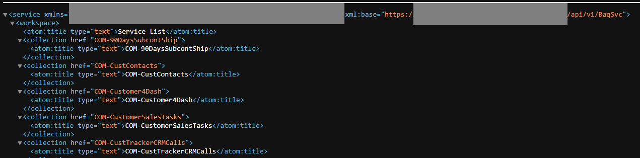

We have a scenario where users are using Excel to make ODATA BAQ calls and some have found that they can see ALL BAQs by using the URL below. Some users are modifying their original call with the BAQs they are finding from said URL.
hhttps://redacted.local/redacted/api/v1/BaqSvc
Is there a way to prevent unauthorized users from accessing this link?
