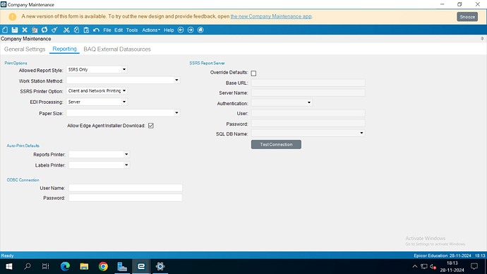

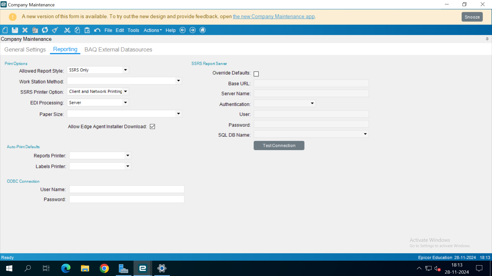

Also verify Company Maintenance

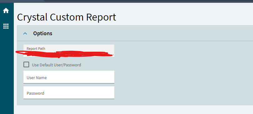

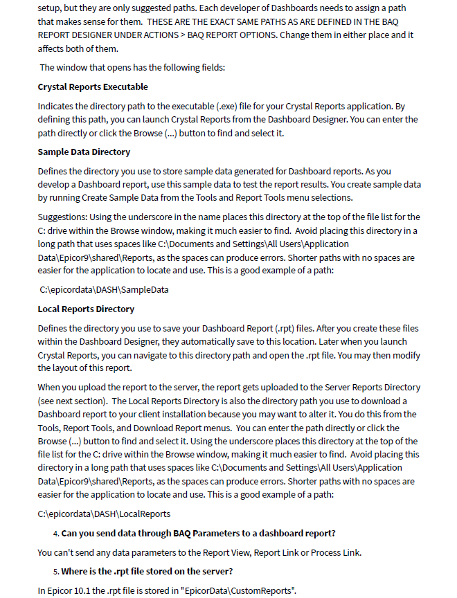

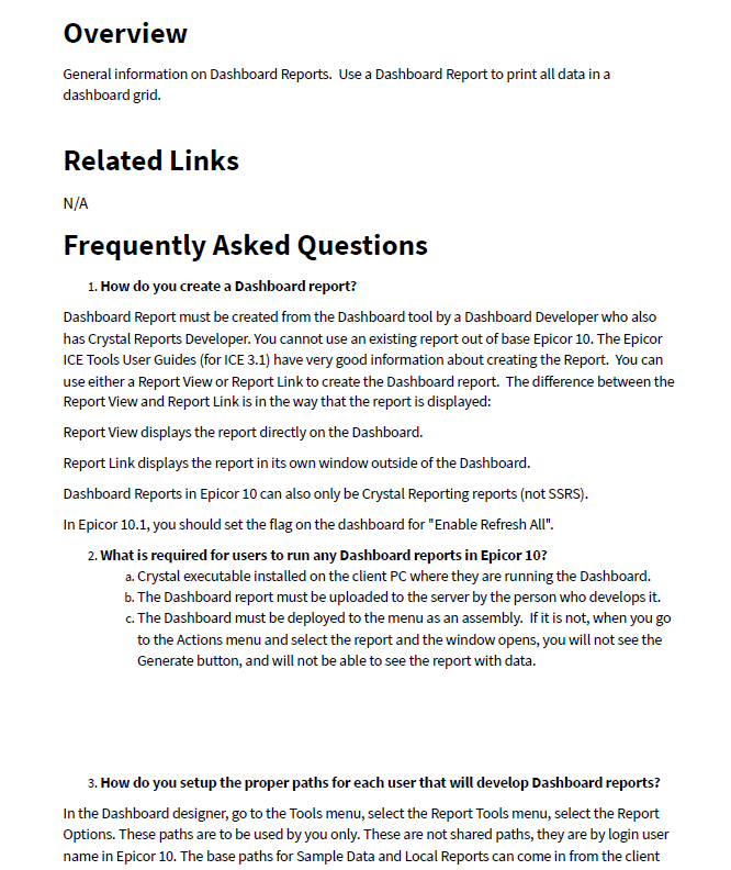

Hello @Doug.C , @Mark_Wonsil @DaveOlender ,
I would like to clarify that this is not a standard or BAQ-based Crystal Report. It is a Dashboard Crystal Report, which was a functionality available in older Epicor versions like Epicor 9. Using this feature, we could create Crystal Reports based on dashboard results.
I understand that this functionality is no longer available. While this Dashboard Report is currently working fine in Epicor 10, it is not functioning as expected in Kinetic 2024.x.
For more details, please refer to the following link:
Dashboard Crystal Report Issue - EpicCare
I’ve also attached a relevant screenshot for your reference.
Looking forward to your thoughts or guidance on this matter.
