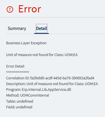

I have a problem with one job giving an odd error whenever “Get Details” or “Delete Subassembly” clicked. The error says “Unit of measure not found for Class: UOM:EA” which seems like a part doesn’t have a UOMClassID. I’ve checked all the parts and nothing is missing a UOMClassID.

Wondering if there is a part record that somehow got corrupted. I would expect this to read something like
“Unit of measure not found for Class: COUNT UOM:EA”
It looks like the Class is blank.

I believe UOMConvInternal runs on everything in the job whenever you delete an assembly or get details for an assembly. There is nothing to convert though. The UOMs are the same in the MOM and Inventory.

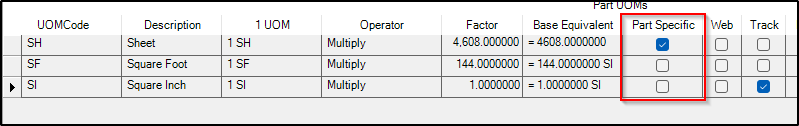

Do you use the “Part Specific” functionality in UOM? If so run query on all the materials on that job to check that the conversion factor is filled in for the “EA” UOM on those materials.
Thanks Chris, I should have thought to check that earlier. Unfortunately, that’s not the problem. They are all set up. It is unlikely to be at the part level since there are 3 nearly identical jobs and only 1 has this issue.
