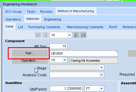

Can you show us a screenshot.
If I recall wasn’t there something where Reference Parts were prefixed to indicate they are just Reference parts.
“Comes up” from where?
I assume you’re in Eng Workbench. When you search via the Part... button on the Materials tab?
Selected from the the Engineering → Parts tab?

I think it is user error. I tried her steps and it looks like there is space in her excel file. Unfortunately she is out next week so I will have to wait to get with her later…thanks for all your input.
So it was “Paste Update” ??
well it was more user error with the paste.
