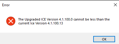

I have upgraded our Kinetic Test environment a month ago. Now I want to upgrade our Kinetic Pilot environment. When I go into Epicor admin console, right click on KineticPilot and select Upgrade Epicor database I get an error.
I already ran the RL and UD files on the server when I upgraded Kinetic Test. I shouldn’t have to rerun those again. Any Ideas?

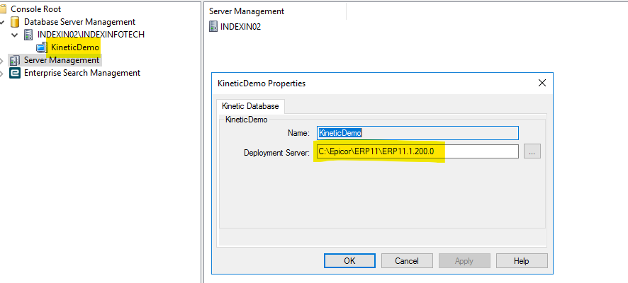

Check the Database properties, its Deployment server must be a newer version.
Thank you!!! I didn’t even look there.
Thanks Fakhri!
