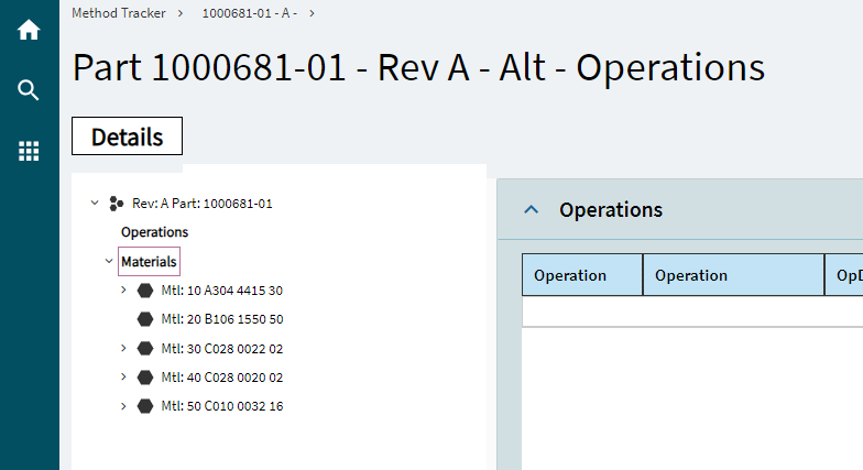

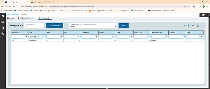

Method tracker as of now shows this after doing the BoO Removal via DMT.

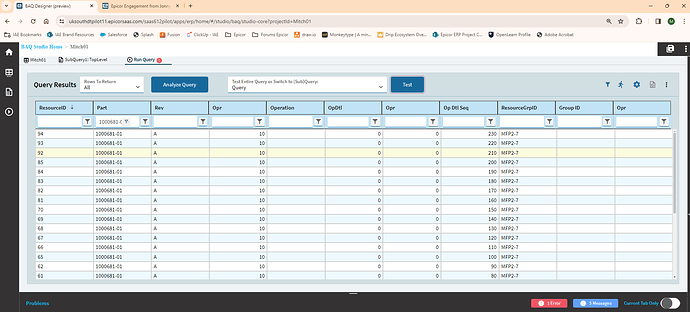

thats great, so i re-run the BAQ, shows 1 line… I dont know how or why, but i proceeded anyway.
I picked out the data i wanted to upload via the DMT
ECOGroupID Company Plant PartNum RevisionNum OprSeq OpCode OpDesc ProdStandard StdFormat EstSetHours AutoReceive FinalOpr ECOOpDtl#OpDtlSeq ECOOpDtl#ResourceGrpID ECOOpDtl#ResourceID ECOOpDtl#Company ECOOpDtl#GroupID ECOOpDtl#PartNum ECOOpDtl#RevisionNum ECOOpDtl#OprSeq ECOOpDtl#CapabilityID Machines
MB 164584 MfgSys 1000681-01 A 10 HNDWLDST Hand Welding STD 4 PH 0.5 TRUE TRUE 10 MFP2-7 115 164584 MB 1000681-01 A 10 1

So i head into the BAQ: hundreds of lines of data again

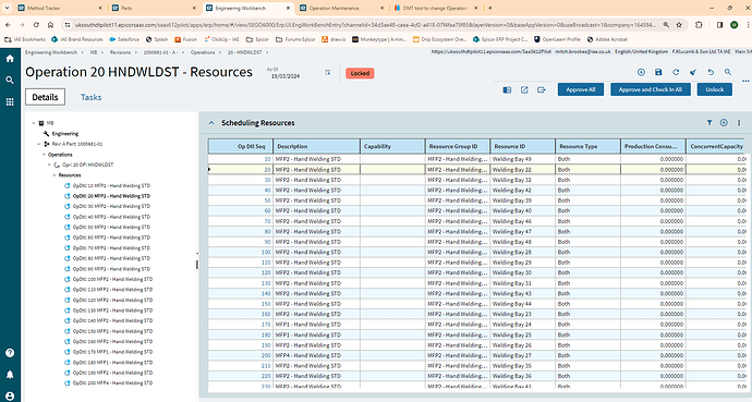

So revision A of the part, checked out to the Engineering workbench
And add in the Operation

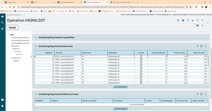

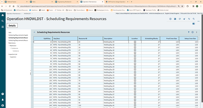

Resources in (as i discussed with a consultant), not a resource group, but now here is the question…
How do i get my BoO uploaded to do HNDWLDST on a specific resource inside that Operation, as part of the method, so some more context
  • Welding bays all “HNDWLDST”

Forget the BOO for now. Your Operation Maintenance setup doesn’t look right.
The way you have WLDHNST setup, you’re saying that every individual welding bay is required by default every time you add the operation to a BOO.
There are very few instances where you will need/want individual resources set as the scheduling requirement in operation maintenance. You just want to add the single resource group.
When you create your BOO, that’s when you can assign a specific resource to that parts revision. However your probably don’t want to do this a the BOO level either. You probably just want the Resource Group again.
By assigning an individual resource to an operation you’re saying that that is the ONLY resource that can be scheduled to complete that op. If you leave as just the resource group, when the job is scheduled the scheduling engine will assign the first available resource in that group.
If certain parts can only be welded in certain bays you have want to consider making some smaller resource groups that separates the bays into functional groups. Even if there is only one bay per group, that’s probably going to be a more effective setup then lumping them all together in single group. Every resource in group should be functionality identical.
*The reason you have hundreds of lines of data when you query you BOO is because every operation has every bay listed as an individual scheduling resource.
After you clean up the default scheduling requirements in Operation Maintenance use DMT to delete all of your BOOs and start over. This is the best method for fixing OpDtl records.

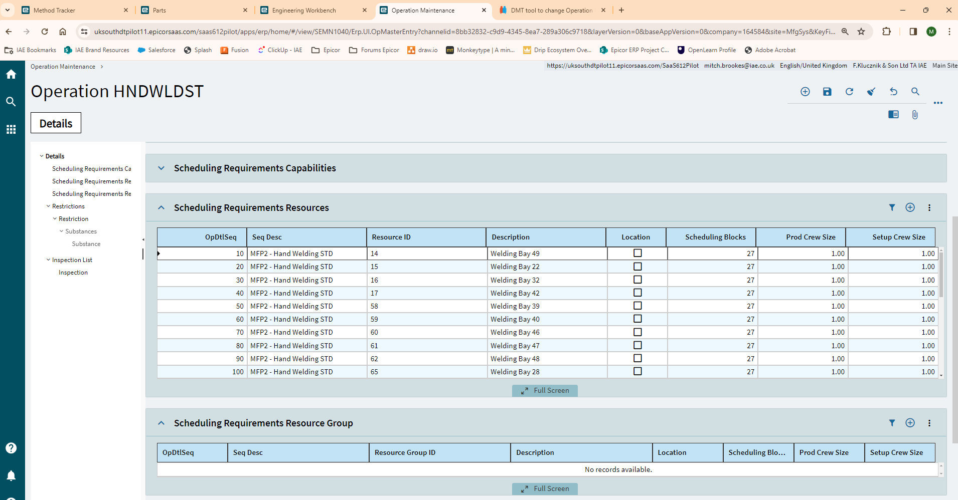

Ive got to a point now where I have my resources removed, resource groups are now showing multiple groups against 1 operation… DMT error, once that is clear im good to go

If this the BOO DMT you may have to open the Engineering Workbench and Approve and Check In all revisions and try deleting again. Best guess.
“Engineering Change Order” suggests there’s something in Engineering Workbench using the ops you’re trying to delete. Delete records in EcoOpr (or even the whole EcoRev) and that should remove that error.

i manually removed all the bits in the operations, added in the group, run the BoO DMT with the 2 headings in
This has then assigned the resource ID to the part
Exactly how i wanted it too,
your suggestions on the operations were correct, however it has allowed me to select a specific ID within that resource group to perform the operation on.
