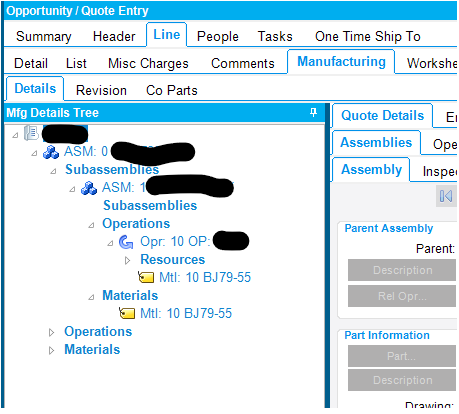

In dataview for [“JobMtl”] I’m only finding Mtls for AssemblySeq 0 and I need Mtls from AssemblySeq > 0
e.g. in the screen shot here, I need Mtl BJ79-55 to be available in a dataview.

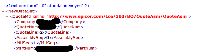

        DataSet DSJM = new DataSet();
        DSJM.Tables.Add(edvJobMtl1.dataView.ToTable());
        DSJM.WriteXml(@"C:\dsJmSyncA.xml");

So I clicked on Mtl BJ79-55 in the Operation and then it was in my edvJobMtl1.
So that’s good.
I noticed that edvJobAsmbl1.Row == -1 after doing that.
What I’m trying to do is simulate that click via EpiDataView related code.

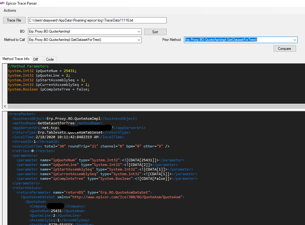

Thanks to @josecgomez Trace Parser I can clearly see what happens when I click the Mtl as shown in the first screen shot of this post. However, I’m having a heck of a time trying to implement that in code.

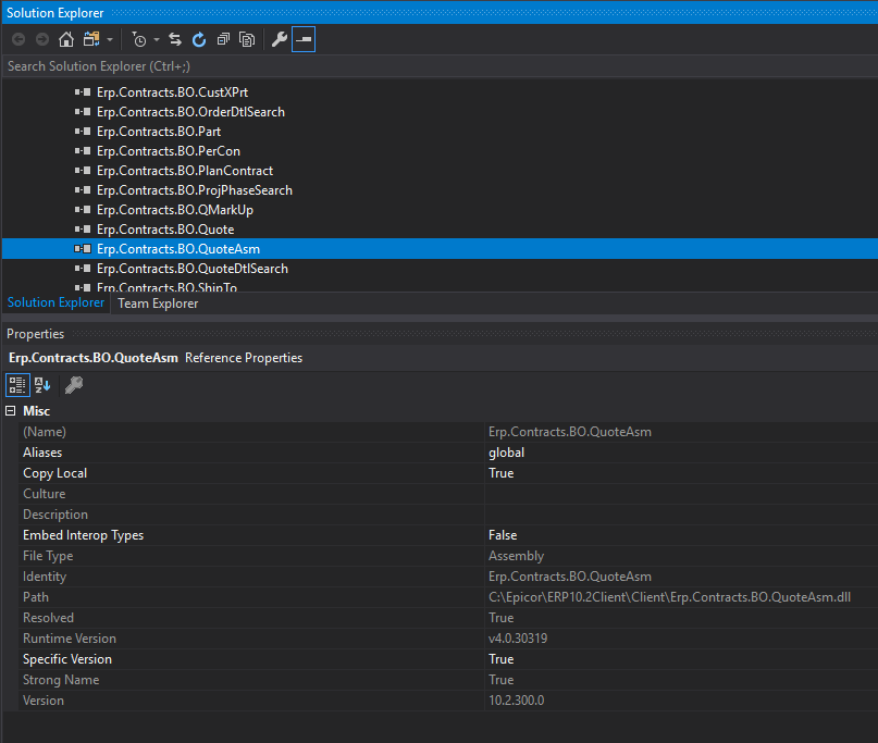

In Approach 1, I didn’t find the dll’s for QuoteAsmImpl. Nor do I know exactly what the ?? parameters ?? should be. Therefore, I tried Approach 2.
In Approach 2, I’m getting Error: CS0246 - line 739 (2667) - The type or namespace name ‘QuoteAsmAdapter’ could not be found (are you missing a using directive or an assembly reference?)
When I have the references and the using Erp.Adapters;
I’m hoping I’m close to getting this to work, but currently stuck. Does either of the Approaches work for anyone?

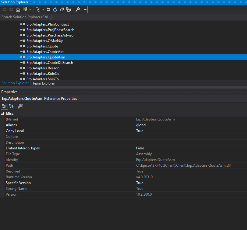

So circling back to this, I got past the reference problems and this code works…
