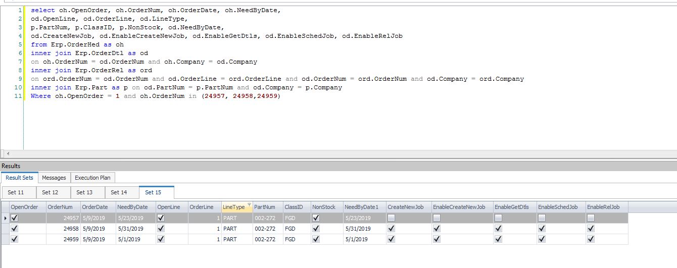

Behind the scenes it looks like there are a few epiMagic fields. Anyone know what sets them true/false. It makes order entry fun because sometimes the warning message appears others not. We had a few jobs not get created with a new OE person, which is how we caught it.
Here is what I am seeing as the differences on the order details. Just want to know how to make the warning message prompt each time.
Check to see if the Part num on that line is set up as a Sales Kit in the parts master. MRP won’t create jobs for sales kits.
