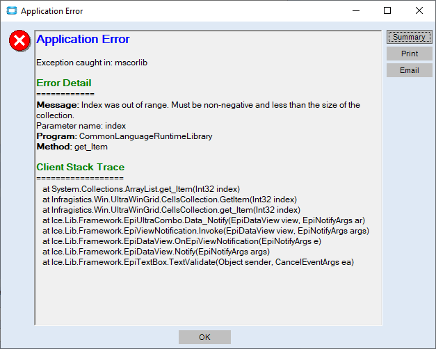

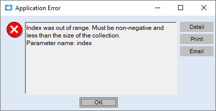

Hey guys…ran into an issue tonight after moving a Order Entry Customization from Pilot into live…never seen this before and not sure why I am getting it. When I go to create a new order, and I enter a customer ID I get the following error:
“Index was out of range. Must be non-negative and less than the size of the collection.
Parameter name: index”
After which it won’t load any of the customer information…Anyone seen this before??
Do you have any new custom combo controls?
I do have some new Epiultra Combos and some BAQ Combos - I will look into those and see if that makes a difference…
Looks like one of the two BAQ combos was causing the error…just have to figure out why (as I have the BAQ that I am calling out in live)
